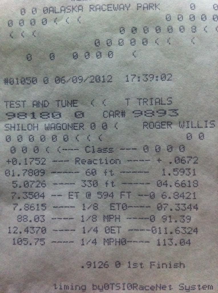

Originally Posted by dick_landy
Here is what a can contribute in regards to the LS9 plug:
-I have been running the same set going on my third season.
-They stay clean.
-At 13.8psi my 5.3 laid down 552rwhp in 86*f with 0 knock retard.
At 14 psi, my 5.3 ran 11.62 & 11.63 at 113 mph. Never had that combo on a dyno, but the online calculators put it at 609 rwhp. Tim Z's truck (basically the same configuration/weight as mine) dyno'd at 627 rwhp with a nearly identical timeslip, so I believe the 609 is a realistic number.
I ran BR7EF NGK plugs. Platinums in my truck required a much less aggressive tune, thusly it made quite a bit less power.
BTW, if you decide to experiment with spark plugs, take the time to learn how to read spark plugs. You must cut the threads off the plug to properly read them. The spark plug is a very valuable tuning tool if you know how to read it. The spark plug will tell you what the engine wants, in regards to heat range, gap, and fueling. Wideband AFR is not the king, spark plug is the king.
