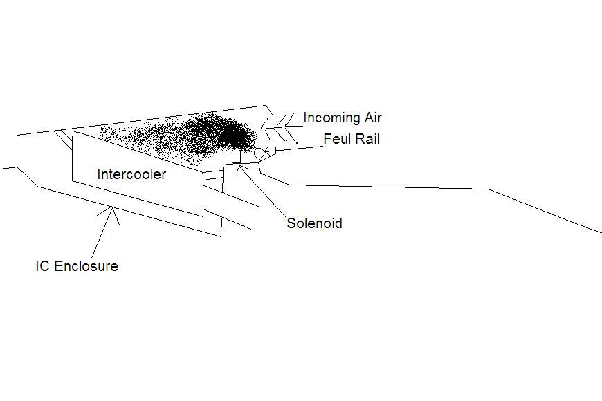

First thing is I have 2 nitrous kits and I want to use both of them. I will have a small shot on the motor along with the turbo and the meth injection. I'm really only wanting to use the second kit on the intercooler because I have it and it's doing me no good in the garage and I get nitrous very cheap. That said, I want to do it right.
The scoop will not be open to the engine compartment. It will be boxed in and insulated. I have meth injection and would like my second nitrous kit on the intercooler and have the air through the scoops. I am able to tune on the fly so if I need to change for temp I can. I just want all I can get out of it for the few times I run it that hard. I will be on low boost (13pounds) 90% of the time.
This is what I'm asking for guys. Thanks for all of your input.

With a IC that big it would probably take at least a couple spray bars or you might could modify a Fuel Rail off something small maybe a 4-banger or V-6?!! And you could mount it at the base of the scoop and point it up so the imcoming air pushes it into the IC. Possibly like my very shitty paint rendering.
