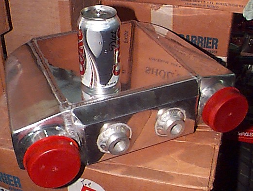

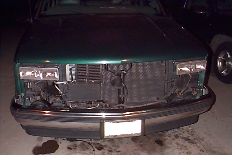

Find a 1200HP rated intercooler and some elbows on EBay and build your own intercooler setup. That's what I did and it works amazing. IAT gets to no more than 25 degress over ambient IAT no matter where the throttle is and that with hot-air intake. I also have a very large surface are heat exchanger up front. Better to go large area and thin than small area and thick when shedding the most heat is desired.
This is the intercooler radiator on the right side:
I've been watching your build. Great work and nice setup. Clean and professional.
