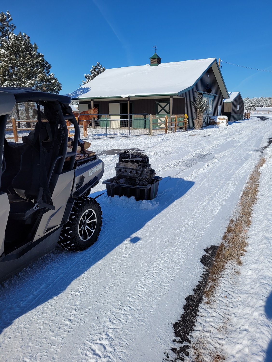

The only good thing about -15* temperature and snow. Sledding the engine from the barn to the house.
