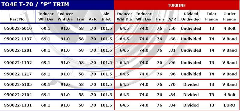

Here are the specs on a "real" Master Power t70 turbo, good for about 750fwhp. (I've personally made 550+ at the wheels with one on my truck)
If you need a good turbo, I can help you with that.

It's a turbine side sizing reference they use, O, P, Q, S. The higher in the alphabet the bigger the turbine wheel.
Also, the "t" sizing is generally referring to the minor sizing of the compress wheel, like with the above charted T70, it has a 69.1mm minor size, so they call that a 70mm turbo.
The OP's turbo would be considered about a 53mm turbo.
