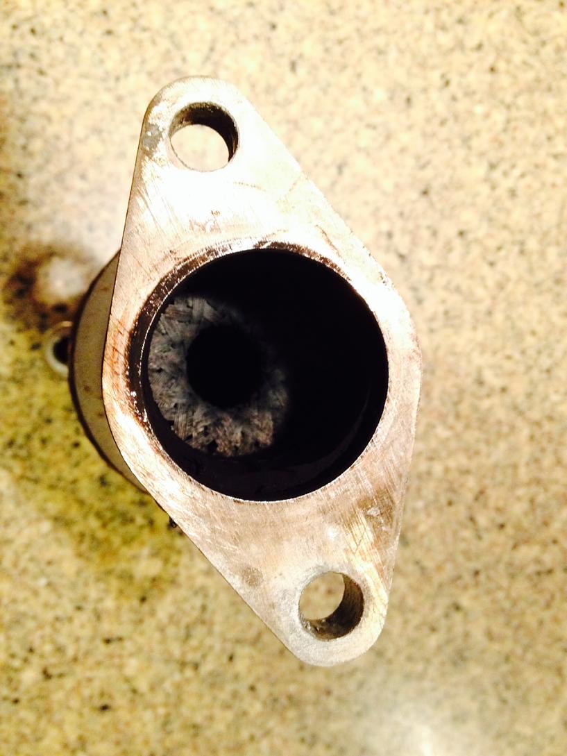

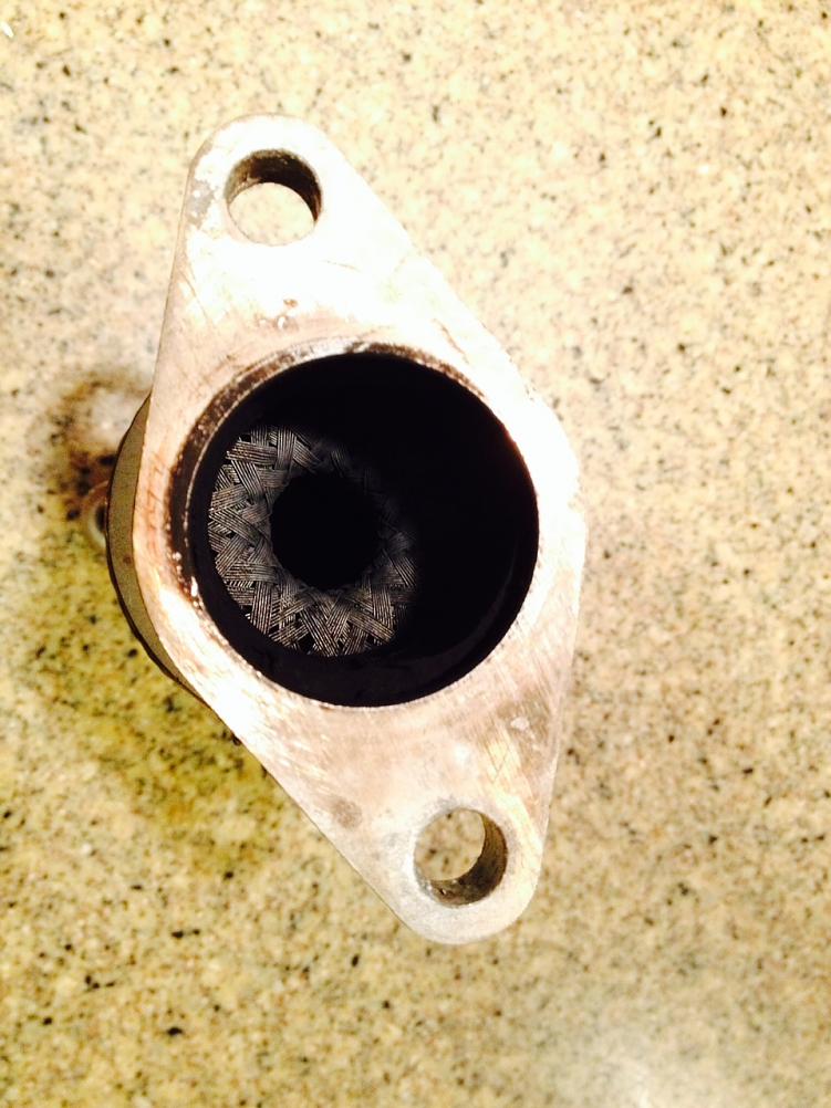

Ok so I went out to the shop to pull the gate off and this is what I found!! I have a 1.5'' flex pipe between the downpipe and wategate the flex liner collapsed resulting in a 3/4'' diameter hole for the gate to dump through.Solid liners are a must on any part of the hot pipes even the gate dump. 20psi with a walbro 255 I wont try it again.pics to come!
