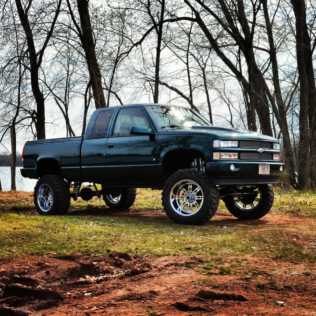

Heres a pic of the truck Name:  IMG_20150419_160322_zpsofbwqomy.jpg

Is this Hulk from LS1truck? If so, glad to see you adding boost! How's the swap so far? I'm also going FI.

Thanks man! yes thats me, Ive got about 500 miles on the swap and loving it! Felt like it needed more ponies so decided to go forced induction. Hopefully I dont break too many things lol
