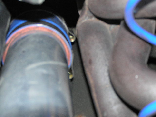

Is anyone else intake pipe this close to the headers? I have gibbson shorty. How much heat can this silicone take? It was 98 degs yesterday. I went out for to long drives. It seem not to be affecting it yet. I think I will get some heat tape to put on it for added protection.

I think I would try to fab up some kind of heat shield rather than use heat tape. It seems everyone says the heat tape will cause your pipes to rust.
