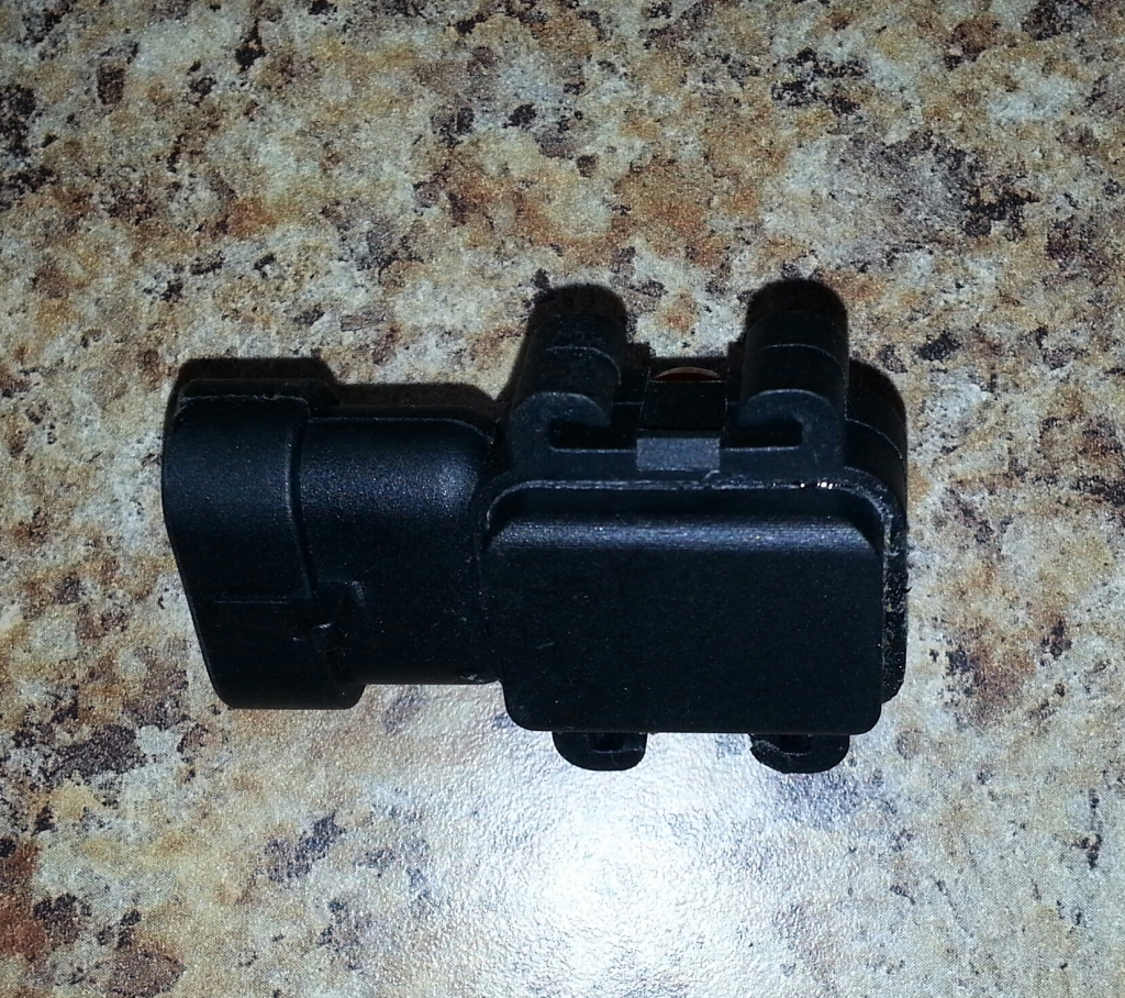

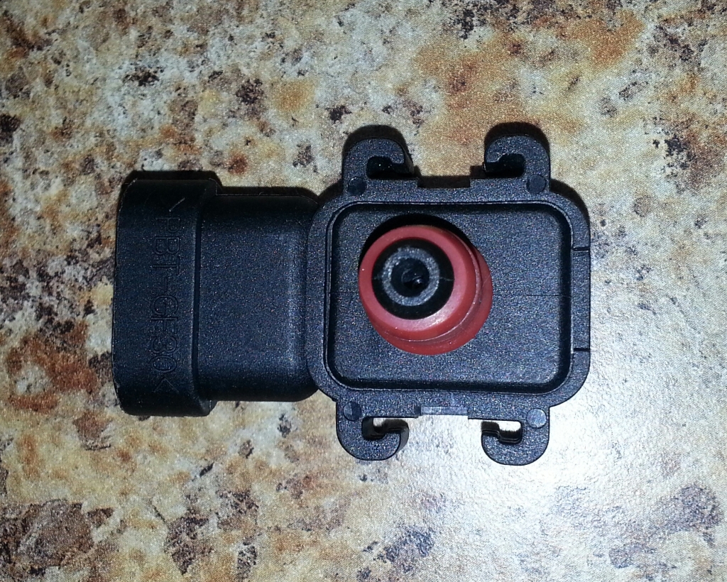

I think dsteck sells them for 85 shipped. I sell my 2.5 bar for 70 shipped. They are brand new cores, not used cores. I have 6 ready to go, but will be out of town until the 9th.

Heres what mine look like.

Gadgetized, yours would be a drop in on my application correct? No harness needed. Do you supply the slope and offset data for the tune with your sensor?

Mine are for the 99-07 classic. Let me do some lookimg into what you need. I can make anything you need, but to be honest you might not even need a sensor like this. How much boost will you be running?

Im running 9psi. My stock map is pegging at 118kpa and throws high voltage dtc's. Your sensors look like mine, but Idk if the nipple size is the same and whether or not the pins are in correct orientation.
