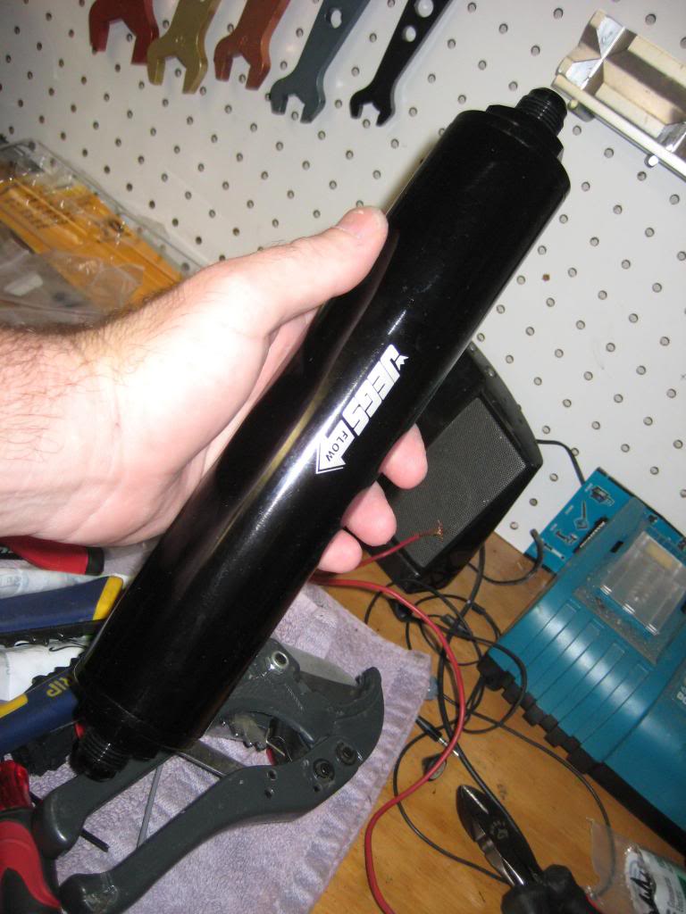

Good luck man !!
I had an issue clogging up the wire mesh 40micron filter. The one i had the element was only about the size of a quarter. It would only last about a month with my fuel cell. Your may not be an issue but i got rid of mine for a jeg 9x2 filter. It is massive and has a paper element.
JEGS Performance Products 150070 JEGS Billet In-Line Fuel Filters, 9'' Long

Jegs says that one is only good for gasoline

You'd have to buy this element to use it with E85:
JEGS Performance Products 150033 JEGS Billet In-Line Fuel Filters, 9'' Long
