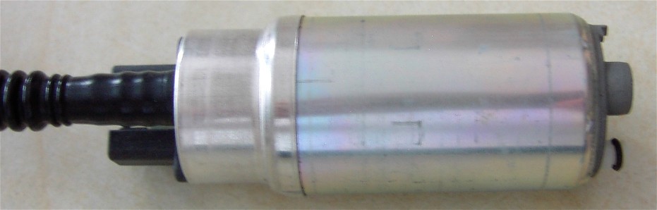

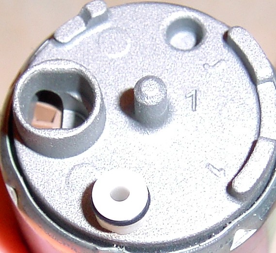

Some compromise by cutting holes in the buckets or doing away with them altogether. So the level in the bucket is whatever the tank level is at. In other cases the venturi/siphon pump is driven by the return side of the intank FPR. So this feature is not lost when the pump is swapped. In my case the venturi pump was driven off an small secondary outlet on the bottom of the factory pump. So the Walbro swap killed the venturi pump.

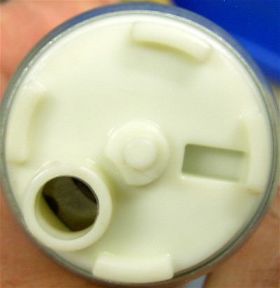

So are you talking about something similar to my factory pump or something like the Walbros that have been modified with an extra outlet on top to connect a line to drive the venturi/siphon pump that keeps the bucket filled? They are 2 different types of pumps. The factory pump is designed so that the venturi feed is not affected by the main outlet line pressure.
The reserve capacity of the existing buckets may not be adequate to handle 2 pumps. Particularly the returnless designs that also have the large filter in the bucket. Maybe the additional pump, if required, could have it's own full-featured bucket.
