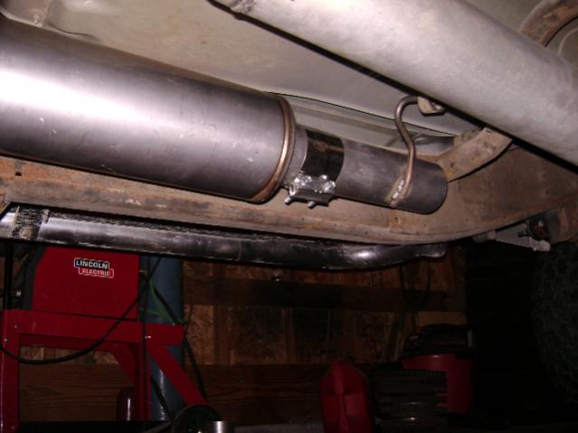

This is 3 inch pipe. When I went to 4 inch, I replaced this pipe directly with a straight joint of 4 inch, and left the muffler mounted in the exact place. The only thing was there was a small 'crick' at the DP, and at the muffler. The bought mufflers packages dont go thru the gap like my current setup. This is the old turbo kit and exhaust. I dont see the advantage of a bent piece of pipe compared to the flow of a straight joint, as well as its easier
When I finish the truck, it will be back to 5 inch DP, to 4 inch straigh joint, to the same muffler.

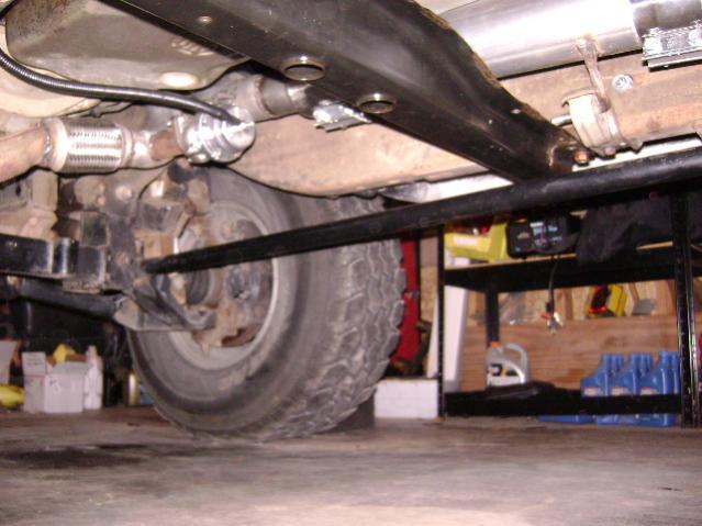

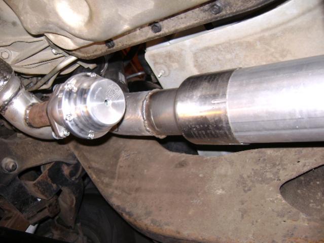

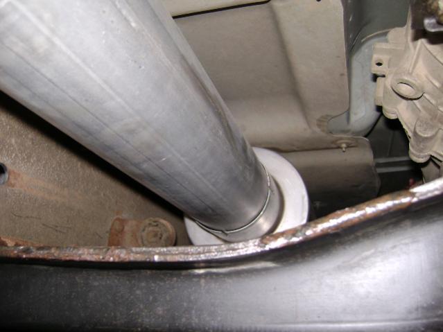

Originally Posted by Atomic
Im really curious about a 4" midpipe off the downpipe back to the muffler....
3" downpipe to a 4" adaptor, 32" of 4"pipe into stock gm duramax muffler, then another 12" of 4" pipe exiting at back of cab and I love the sound at idle and under boost.
