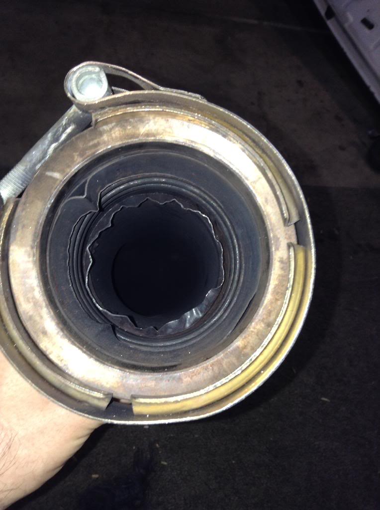

I seriously had no idea that couplings came with or without the mesh inside, makes perfect sense though, it pulled straight out and if I don't have to re-weld another one that would be nice. There has to be someone out there that has grenaded a turbo this way!
Here is a couple photos. The mesh just twisted out. The tabs inside need to be pushed back so they are not sticking out or removed?

this is going to happen to every flex couple with braided mesh inside. The Vibrant performance flex joint with interlock is the only way to go.
