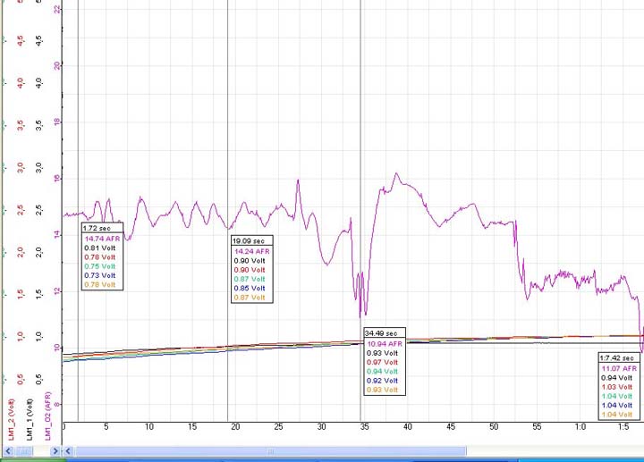

I run a wideband 02 just not hooked to the rpm yet, He is a scan I made running the alky tune with no alky, It run so rich I thought it was safe to run it and watch the 02 in the run

sorry bro, narrowband 02 readings don't mean

Wideband O2's have a 5.0 volt range. It looks like your scan is a narrow band (1.5volts).
