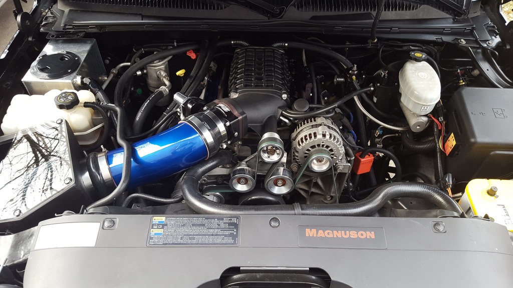

Forgot the updated engine bay pic with new 5" intake tube. As you can see, I'm getting a good amount of belt slip

Try upgrading to larger idlers. Others on here have run similar size blower pulley's with no meaningful signs of belt slip. Dual 100mm should help solve the problem.
By the way, I assume thats a 2.8" pulley?
Will do, thanks brah! Yes it is
Bro, with no belt slip, that's another 2 psi or theoretical 10.3's

Theoretical... hmmm. Sounds like a lot of steam for that 2300! I hope you get there haha
We all have belt dust on our pulley's... I dont think that necessarily means you have belt slip. Are you seeing boost drop suddenly?

What's the spacer behind the TB? I get belt dust but no noticeable slip. Map reading is solid, you think you are loosing 2psi via slip?
