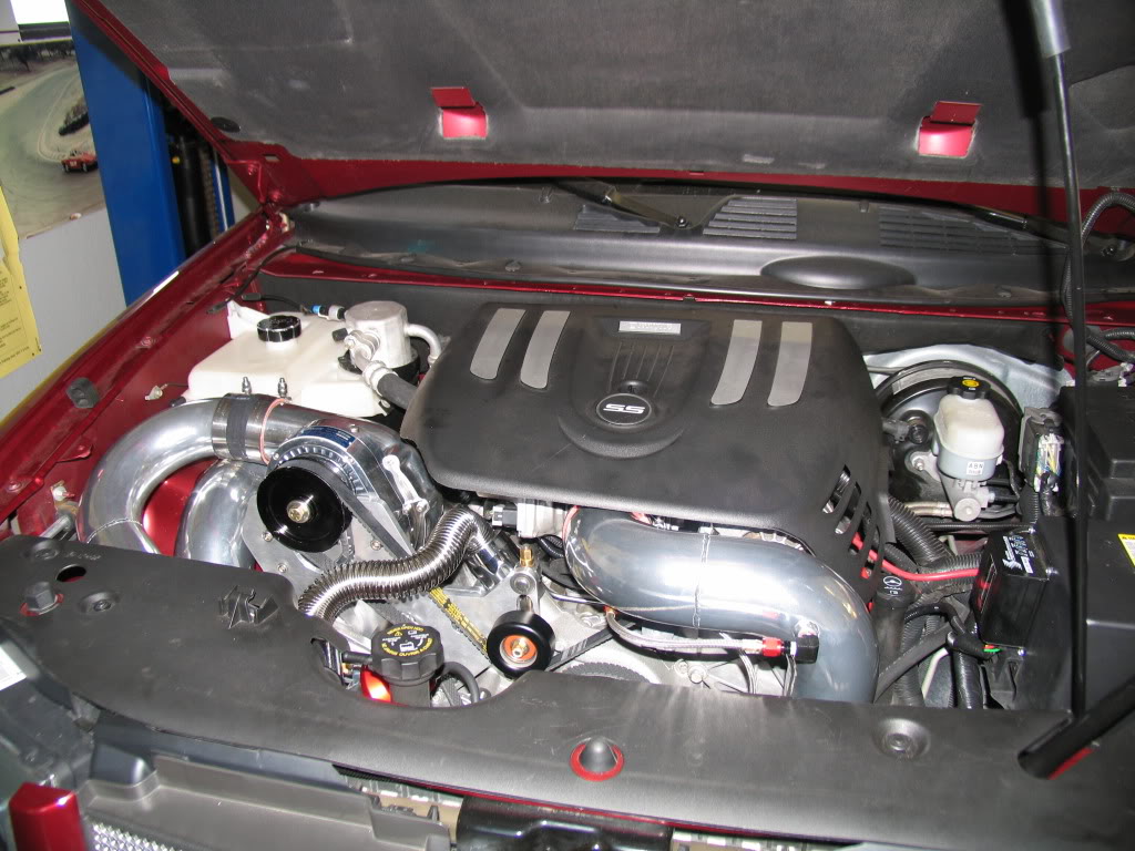

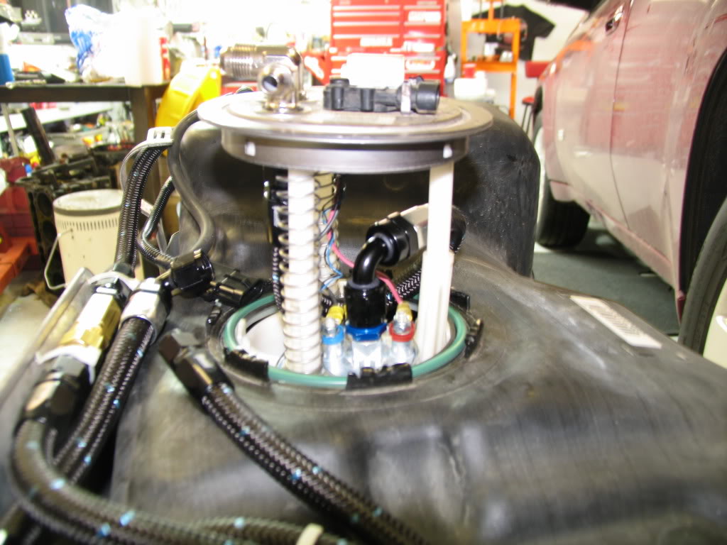

This is my friend Steve's 2006 AWD TBSS with FLT Level 5 w/Billet In/Out and Yank PTB3200, Kooks 1 7/8" Kooks LT headers, custom dual 3" W/out Cats, Magnaflow dual 3" in and out, dual Magnaflow Tips rear exit, Custom Triple Pillar Gauge Pods, Prosport Boost/Vac, Prosport Fuel PSI, Prosport Trans Temp, Innovate LC1 Wideband w/ G3 Analog , HOB Prochager Bracket, Procharger D1SC, Custom Blower Intake, Custom Intercooler, Custom Charge pipe, Vortech Maxflow BOV, LS7 TB, Full Custom Return Fuel System, 60# Injectors, Bosch 040 420lph Primary Pump in Fuel Bucket, Secondary Sumped Bosch 044 420lph on a Hobbs Switch set to activate at 2psi of boost, LQ9 Fuel Rails, LQ9 FPR, Meth Injection, Devil's Own External Dual Nozzles, Snow VC-25 Controller, AIS 180psi 100% Meth approved Pump, Custom Meth tank, Custom Radiator Overflow Tank, Comp Cams 2xx/2xx XER Lobes, PRC Extreme RPM Valvetrain Kit, Comp Moly Pushrods, Welded L92 Water Pump w/ Lingenfelter 160* stat, 2Bar MAP Sensor, IAT relo to Intake, and my Tuning.
Cam Install

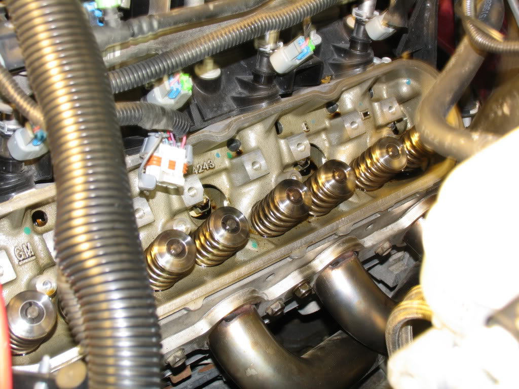

Valvetrain Upgrade
Fuel Pump

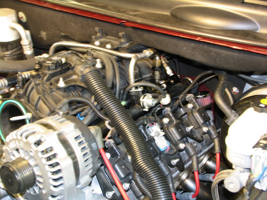

Return Fuel Rails

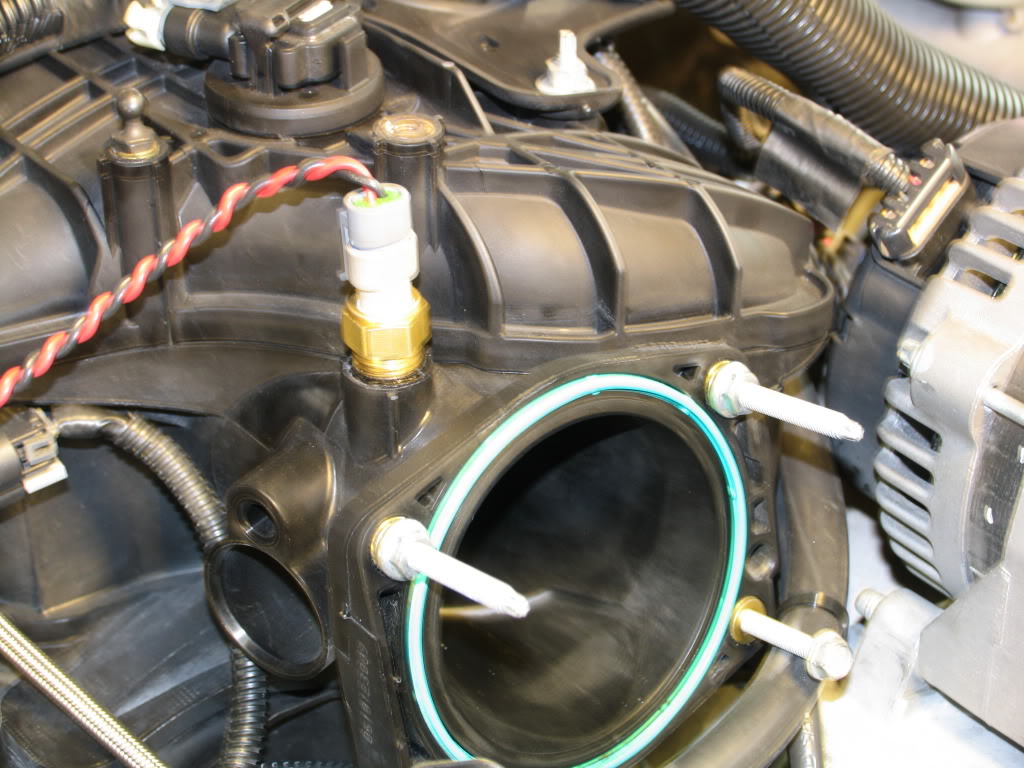

IAT relo

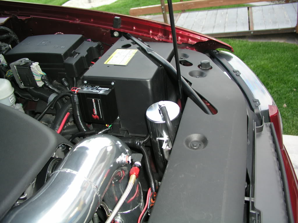

Meth Pump

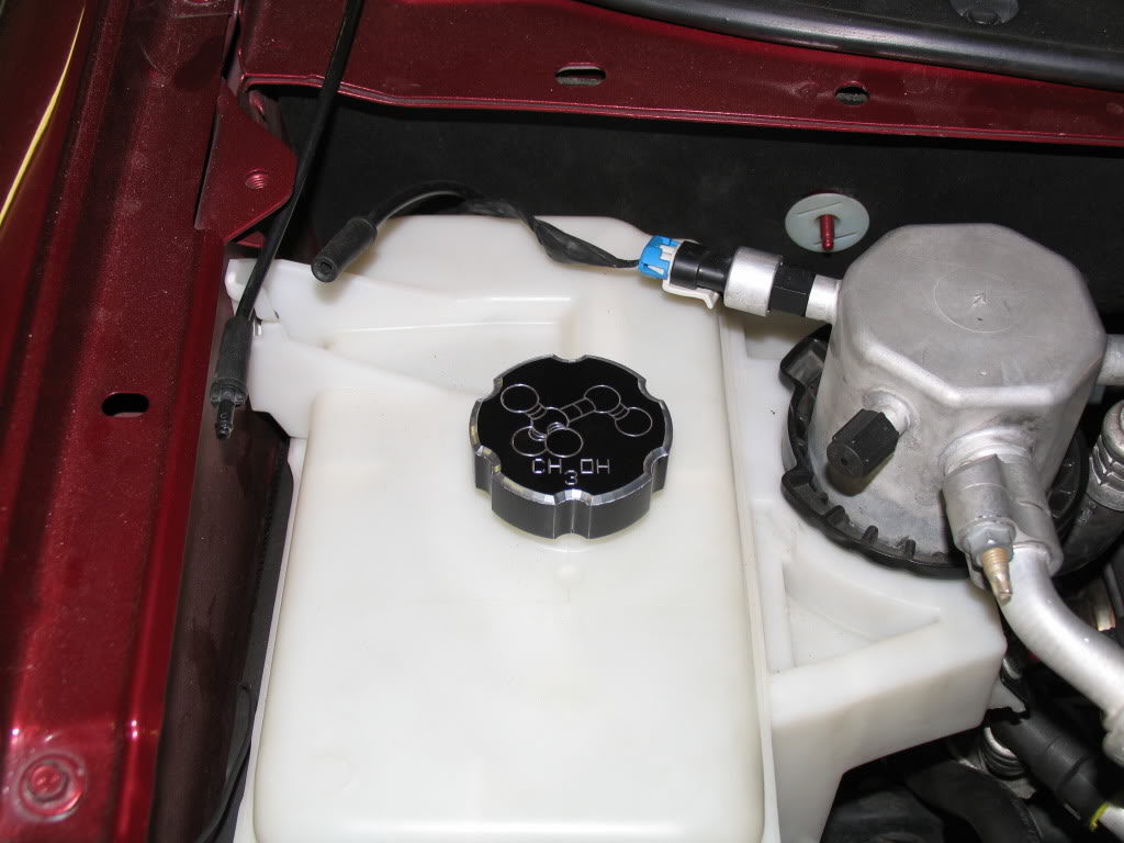

Meth Tank

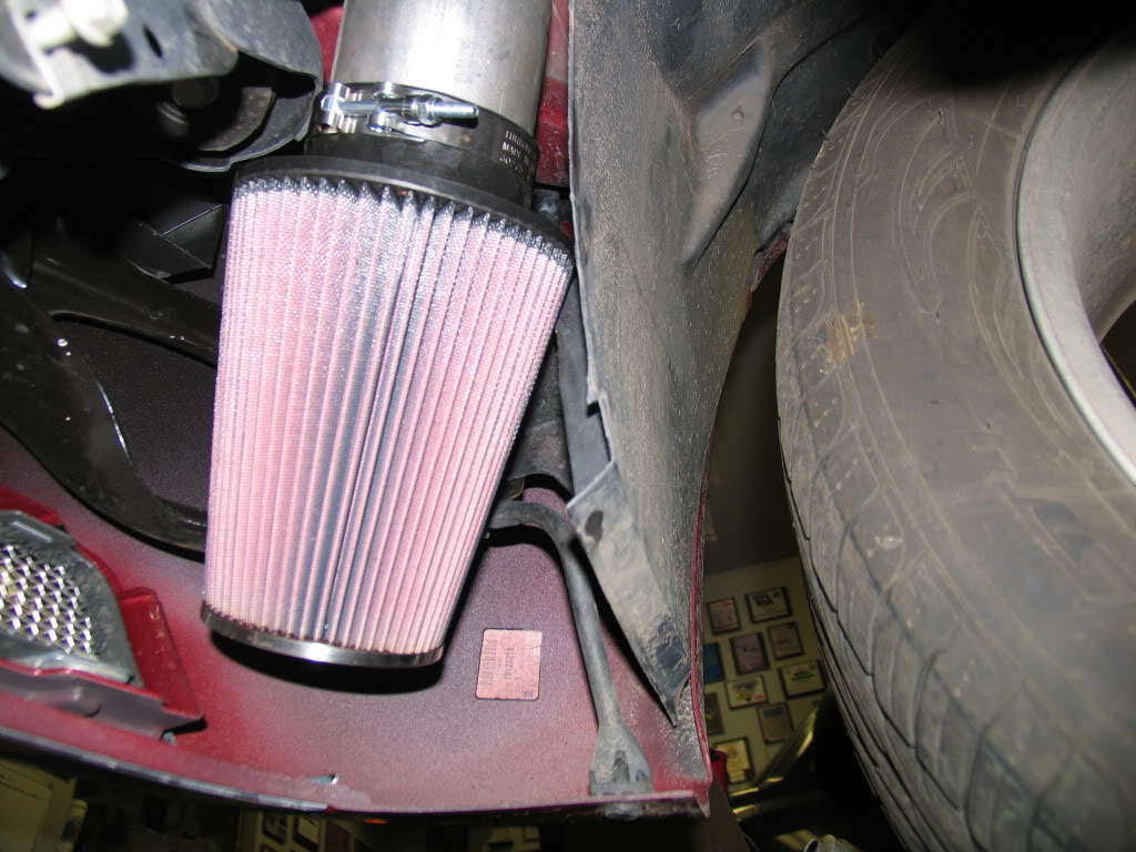

Real Cold Air Intake

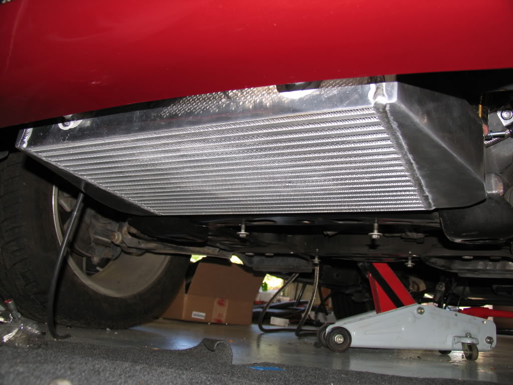

Intercooler
Finished
Here is a quick idle vid I still have a lot of tuning to do on Steve's truck but we are making good progress. Very very few issues and he is at about 200miles on the new setup.
High Definition Idle Vid
http://www.youtube.com/watch?v=3dGVFtBGOm8

glad to see it getting done,maybe he'll stop complaining about it on facebook lol jk.Only thing i dont like is the IC mounting.Itwill suck big time if it gets taken out by something on the road... looks good tho
