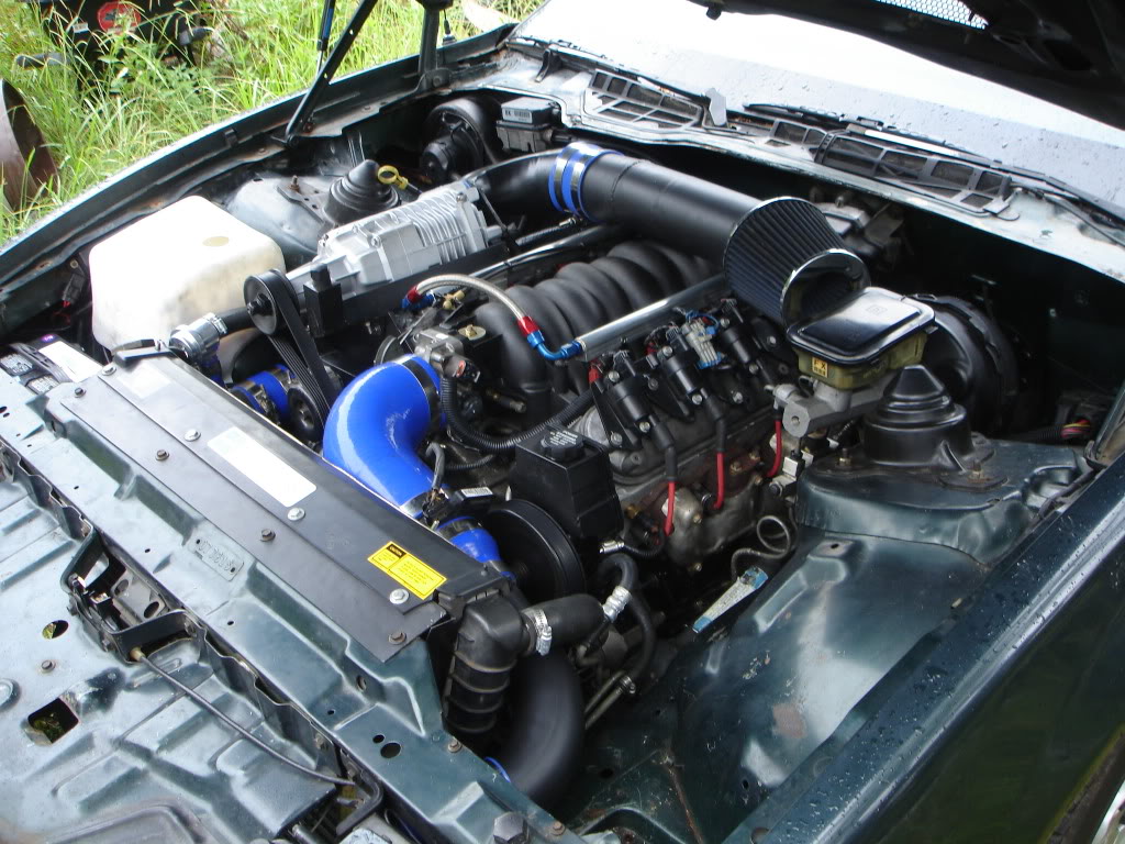

Its a simple setup just like any other roots, just it uses a classic ATA FMIC instead of a sandwiched ATW heat exchanger. To do this, they flipped the blower and ran tubing instead of sealing the outlet port to the manifold directly. Clever take on the old idea, and it worked wonders. They ran more boost with lower IATs than an other roots blower for the time period
The funny business near the TB and blower inlet is for the bypass valve, so when you're cruising at low throttle, the blower is completely bypassed and the engine runs NA for fuel economy. Traditional setups use a butterfly valve connecting the inlet to the pressurized manifold
The M90's work pretty good on smaller LSx engines too, just dont expect huge numbers. Picked up 60hp on a totally stock 5.3 with the stock pulley

Need more of them for larger displacement engines like this 350 SBC

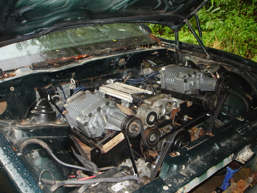

Once you grasp the remote roots concept, any roots can be mounted elsewhere. Here is MUCH more potent overspun M122 on a 6.0
Pros are incredibly good IATs even when spun to the moon. The pictured M122 peaks at 19,500rpms and the IAT is 10-15* over ambient. Since the head unit is remote, it can be mounted anywhere in the engine bay, so tight chassis can keep the low hoodline
Cons are an increase in complexity and they're incredibly loud compared to a traditional setup
