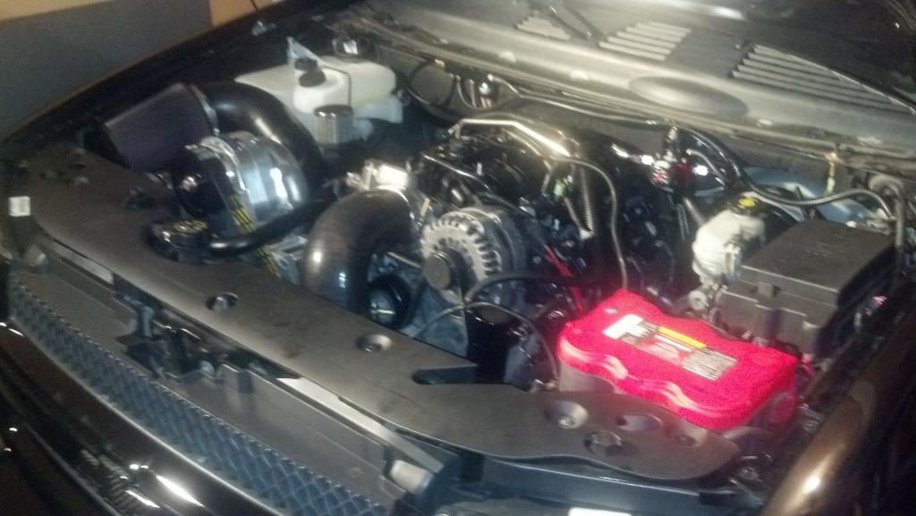

Here is the only engine shot I could find quickly:

awesome , who made the bracket kit ? have any other pics of the brackets , sweet that its on the passenger side. how does the tensioner work?
It a houseofboost kit. Its their standard kit with the exception on different piping from the TB to the IC to allow for use of an LS7 maf.
The setup is direct drive, so the tensioner is right under the blower. This from what ive noticed wraps the belt tighter on the blower.
