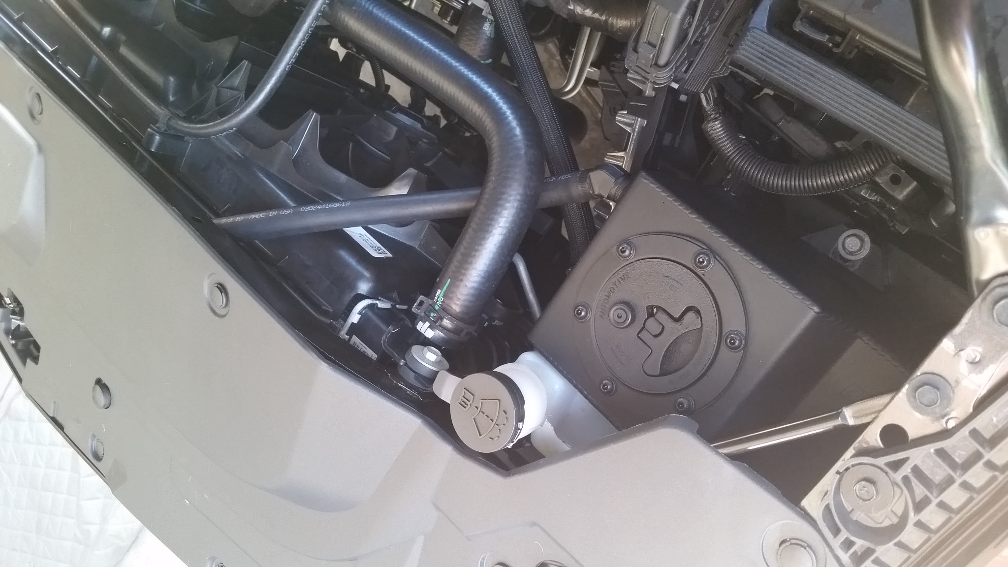

Just finished install for my 16 whipple. Uses oem bracket and bolt to hold it in place. Clean little set up.

How many gal? Where did you buy it? Stainless or alum?

what clamps do you have on the coupler between the intake tube and TB?

got them from silicone intakes.com and then powdercoated black

Whose hx tank is that and how much does it hold. Looking to upsize and get more coolant flowing. tIA

Saw one like it somewhere, it was like $899...I'll see if can find the site.
not sure same one...
http://www.d3peparts.com/product-p/d3pe-c7-a2wtank.htm

It's under 200. Pm me

Looks like the Canton tank I bought off Summit a while back. If it is, you will want to remove the filler neck and seal it with something like silicone, as when you get a little heat in the fluid it will **** out around that "seal". Mine did, and I called Canton to complain. They didn't care, just wanted to sell me their little tool to help hold the bolts on the inside of the tank when removing and sealing.
Why would anyone build a tank with a pressure relief and all, that won't hold pressure??? The folks at Canton could not answer that for me....///Rant off, sorry for the distraction.

That's a MOROSO #63494 coolant tank for 05-10 mustangs
