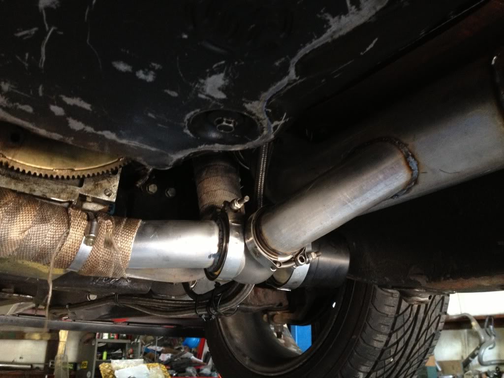

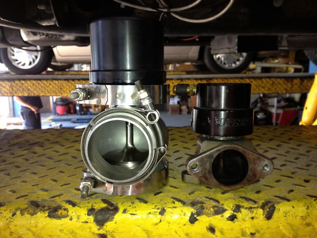

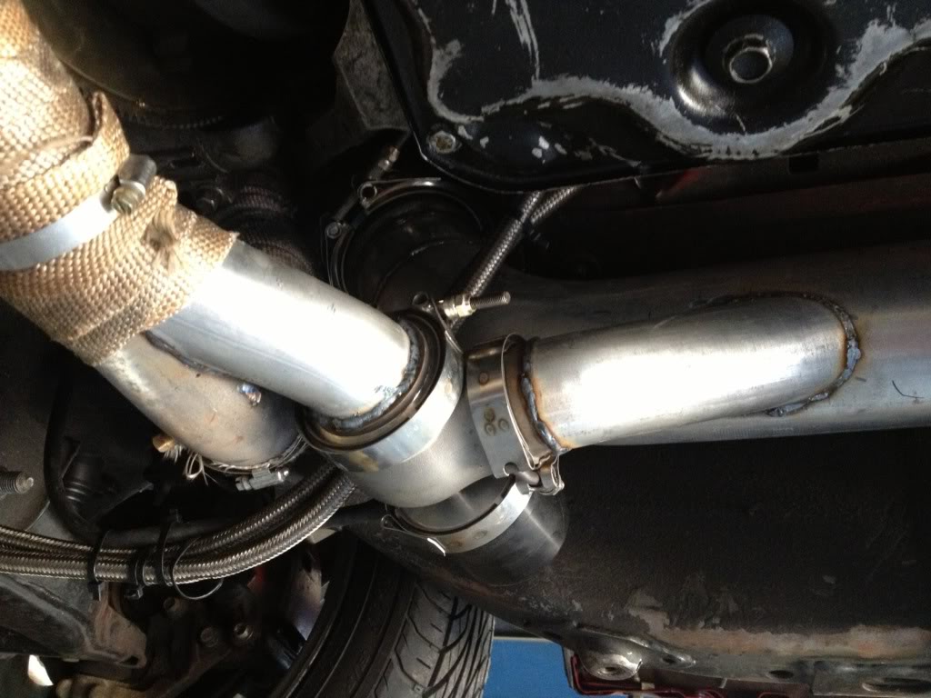

Got a couple PM's on the JGS 60mm. I wanted to give some feedback on it to others interested. It controls boost down to 6psi even above 6k on my setup and keeps boost within 1psi of set boost on shifts, so works great. The piece over all is very solid and would recommend it to any one looking for a large gate or more control. I will say it's large though, so make sure you have room for it. The medium spring is good for a 5-6psi base, firm spring comes in a 10psi base.

In that bottom pic, I think I found all of the zip ties that you are missing.. lol. That gate makes your other one look like a baby.

I was gonna say I found out how the secret to Foose combo and it's that he pre-heats his fuel for better atomization...but I think those stainless lines are his tranny cooler lines.
What happened to your bell-housing cover?
