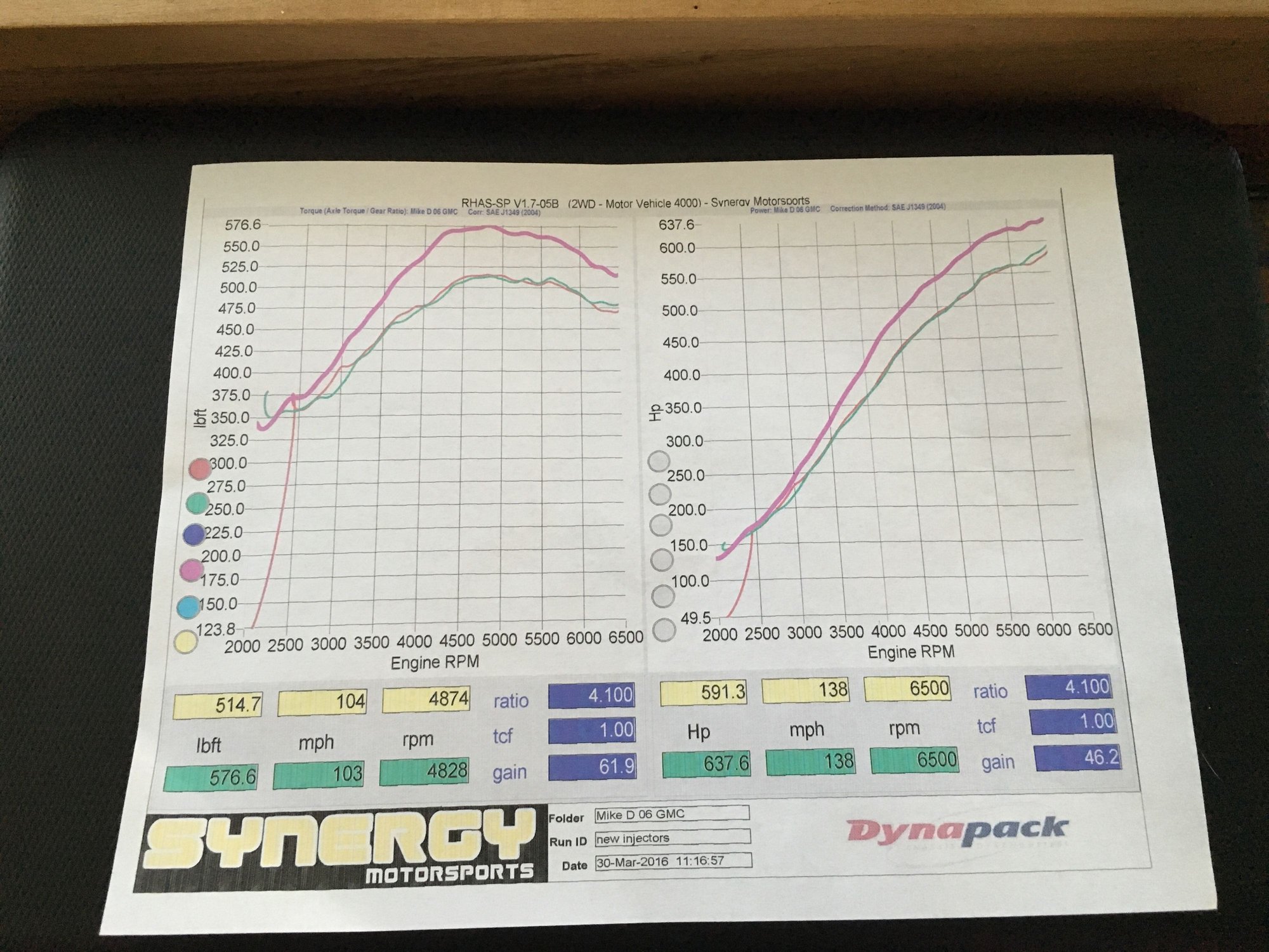

Originally Posted by MikeD.
Well it didn't blow up! Also didn't make the power I was expecting from it, but gains are gains! The torque is the most noticeable seat of the pants.
I must have missed it. What changes where made for each of the pulls on that graph?

Still good numbers!
It would be interesting to see how much IAT rise you're getting in that time. What intercooler are you running?
The first pull was 8psi, no meth, and old 3" exhaust. New numbers were 10psi, meth, and 4" exhaust which picked me up 61ftlbs and 47hp.
