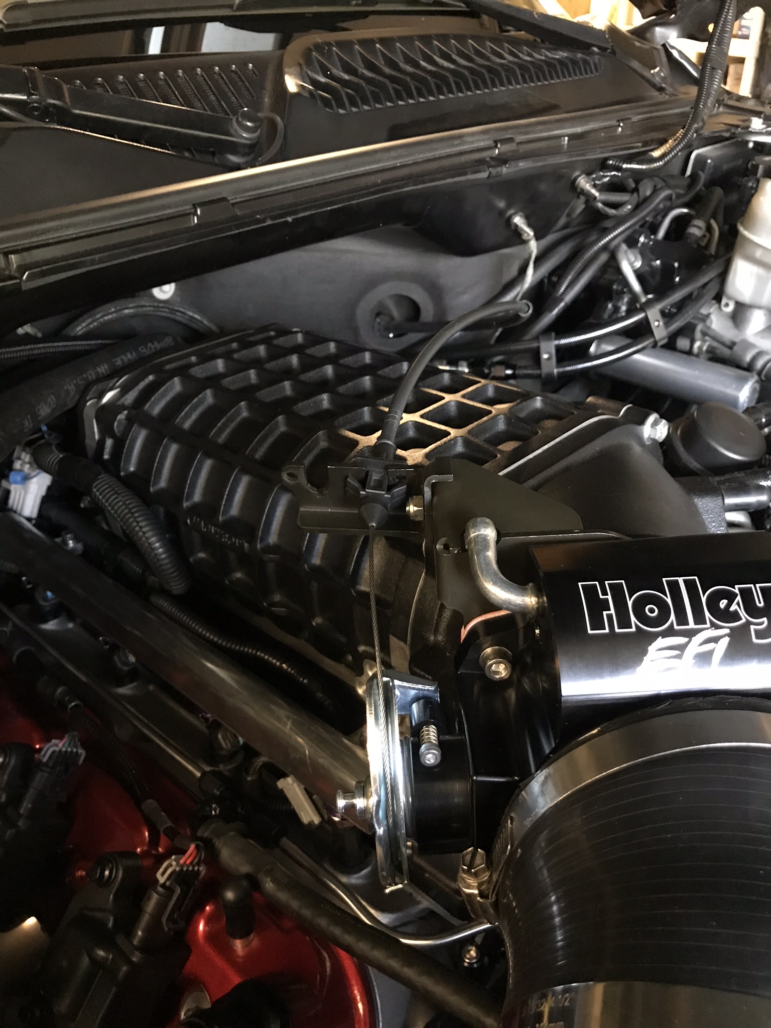

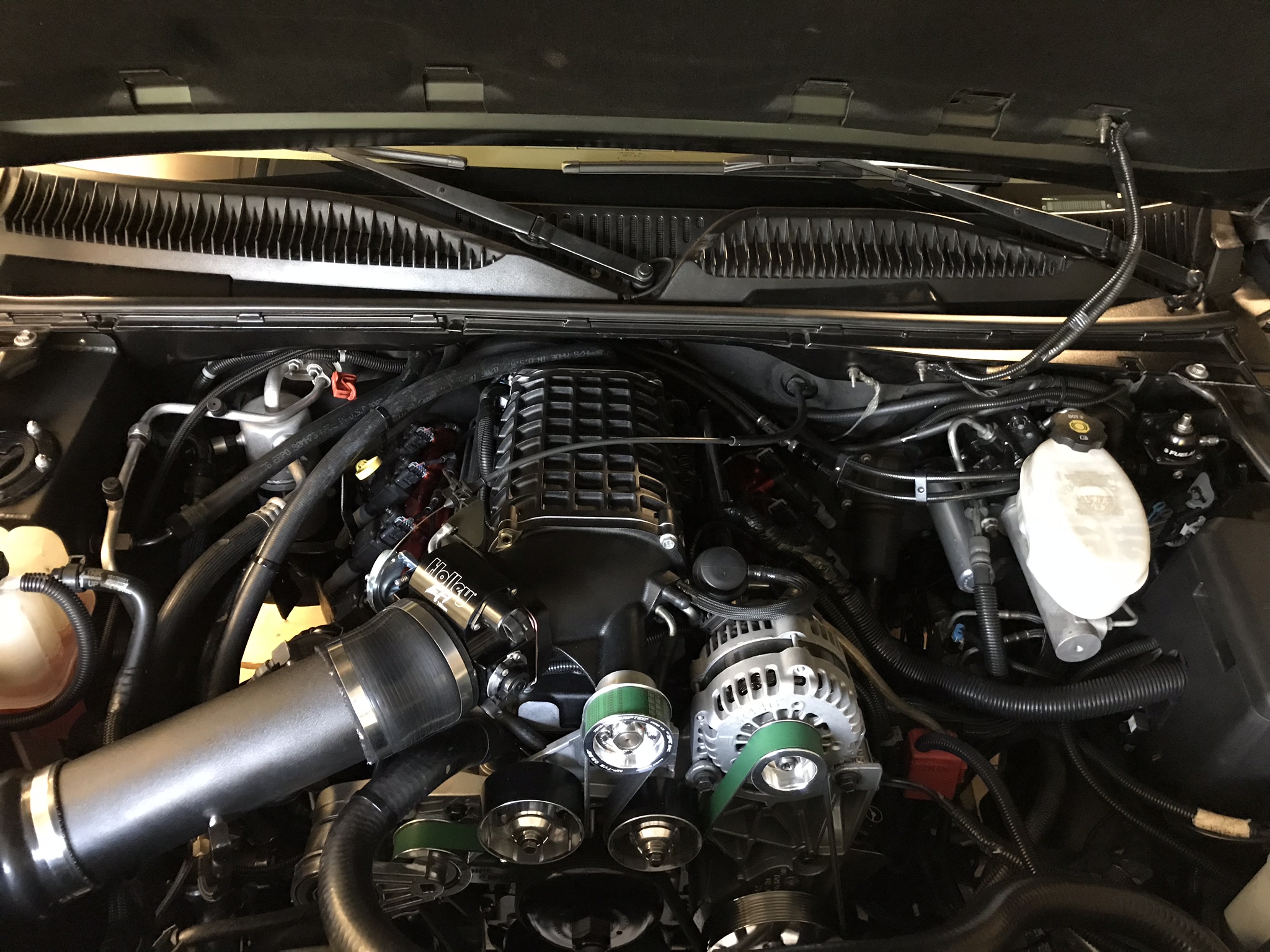

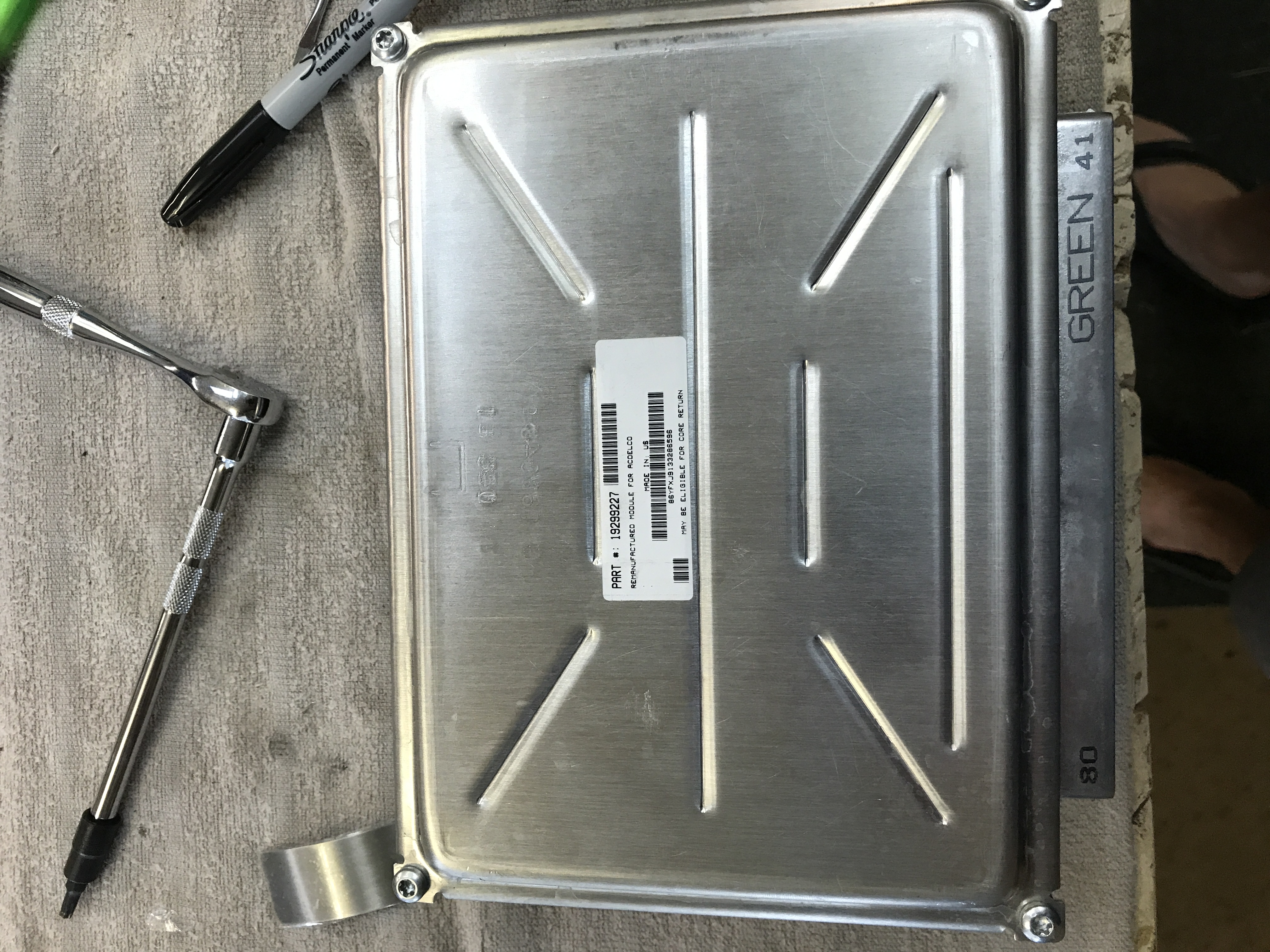

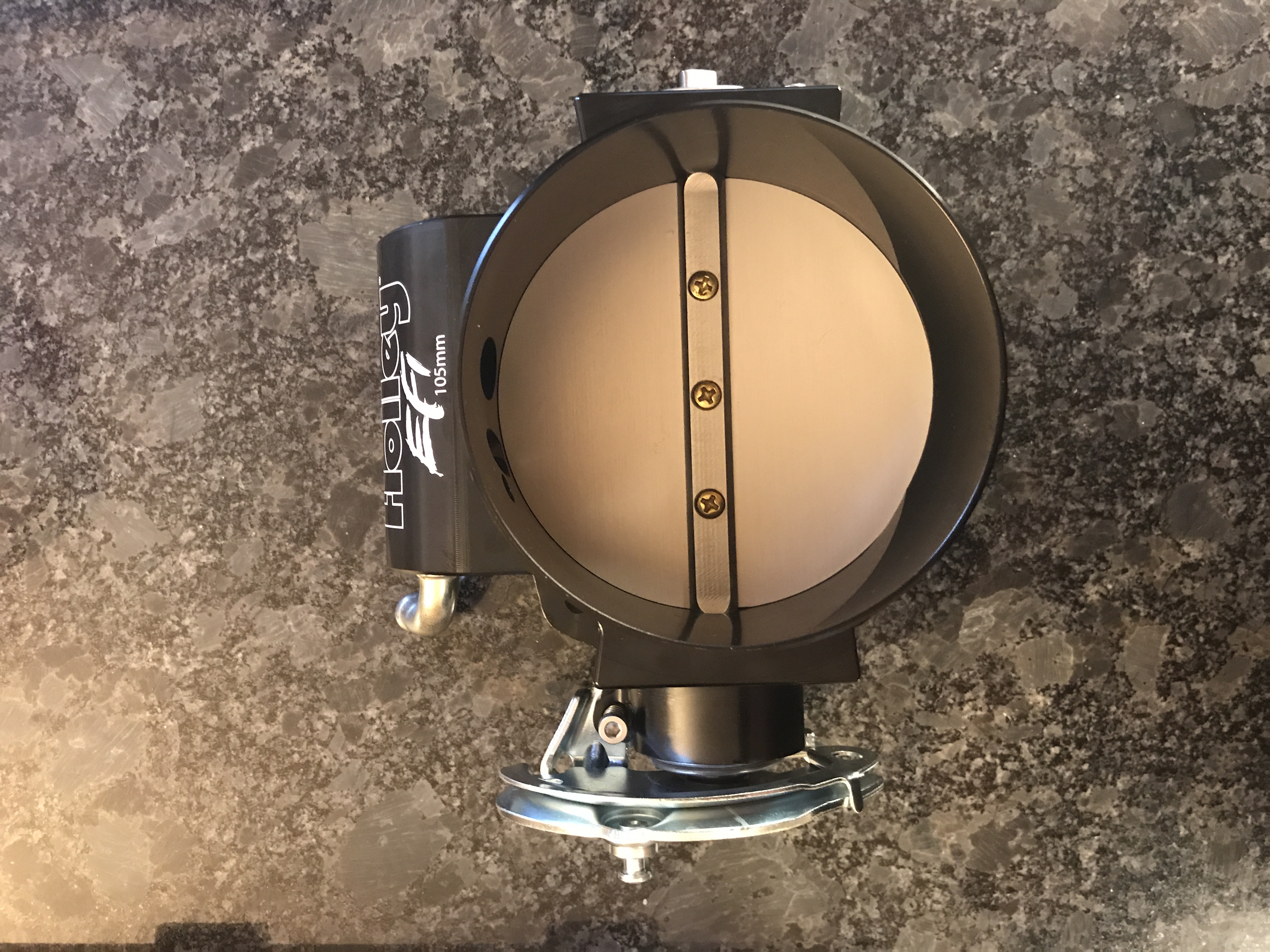

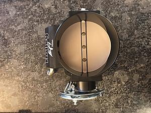

I have most of the parts. Gotta get a pedal plate Sunday from a buddy that owns a junk yard.
Got a p59 IAC computer, built a wire harness and got the throttlebody, sensors and cable.

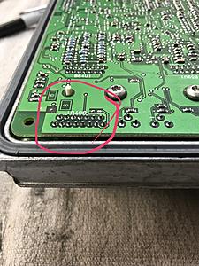

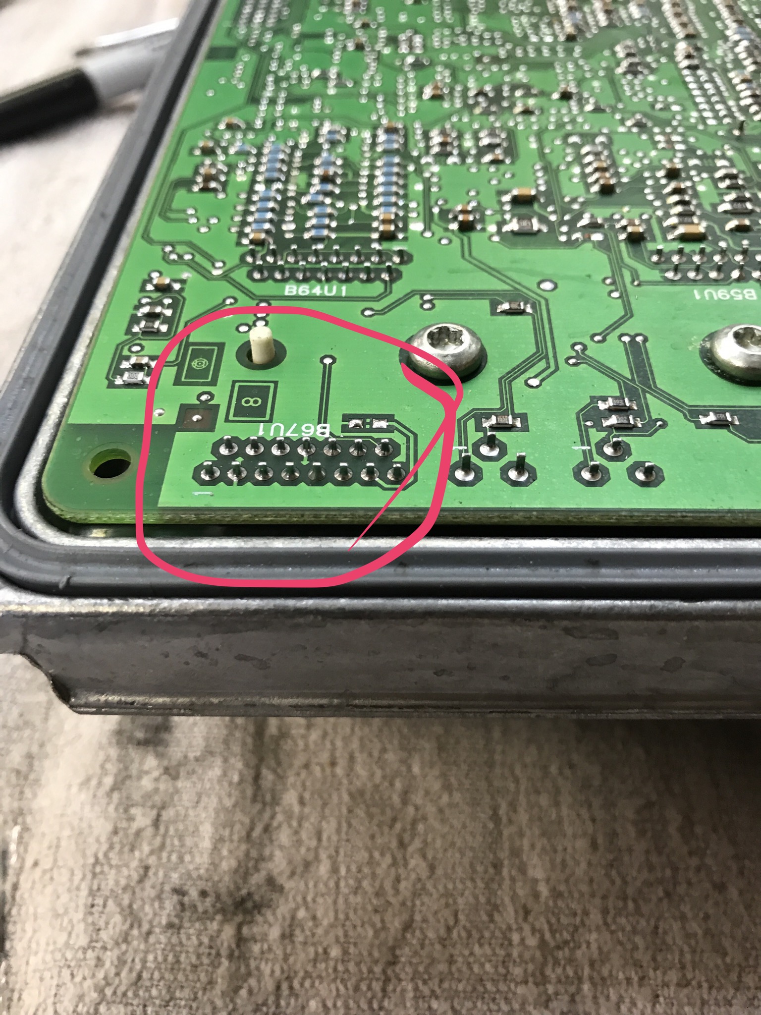

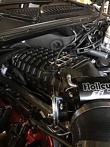

Hopefully tomorrow I’ll have time to wire it up and flash it.

And I am officially drive by cable. Works as advertised.
