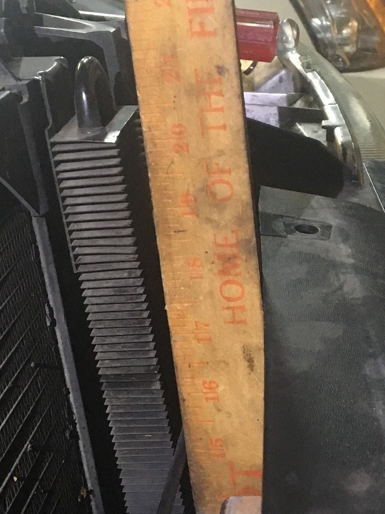

Yard stick sitting in top of the frame.

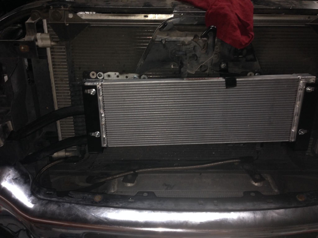

My current intercooler sits 2in below that and has some wiggle room. This pic was taken when i was installing everything. You can see my old turbo intercooler.

Yes. Looking back at my sketch, I believe that 11.5" measurement is from the latch to the radiator support.

So after talking to the guy that is gonna build it and looking at possible mounting places the size changed some. He also mentioned how i should have the feed and return setup for better flow.
I will be going with a 30x16x2.25. Basically it will span the entire width of the grille opening and sit about 1in above the frame rails.
I am gonna draw it up and have it built. He said it was a 2 week lead time.
