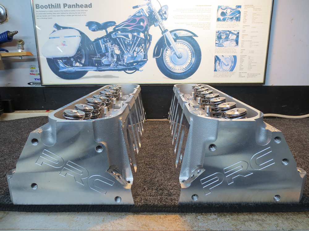

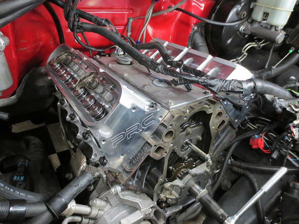

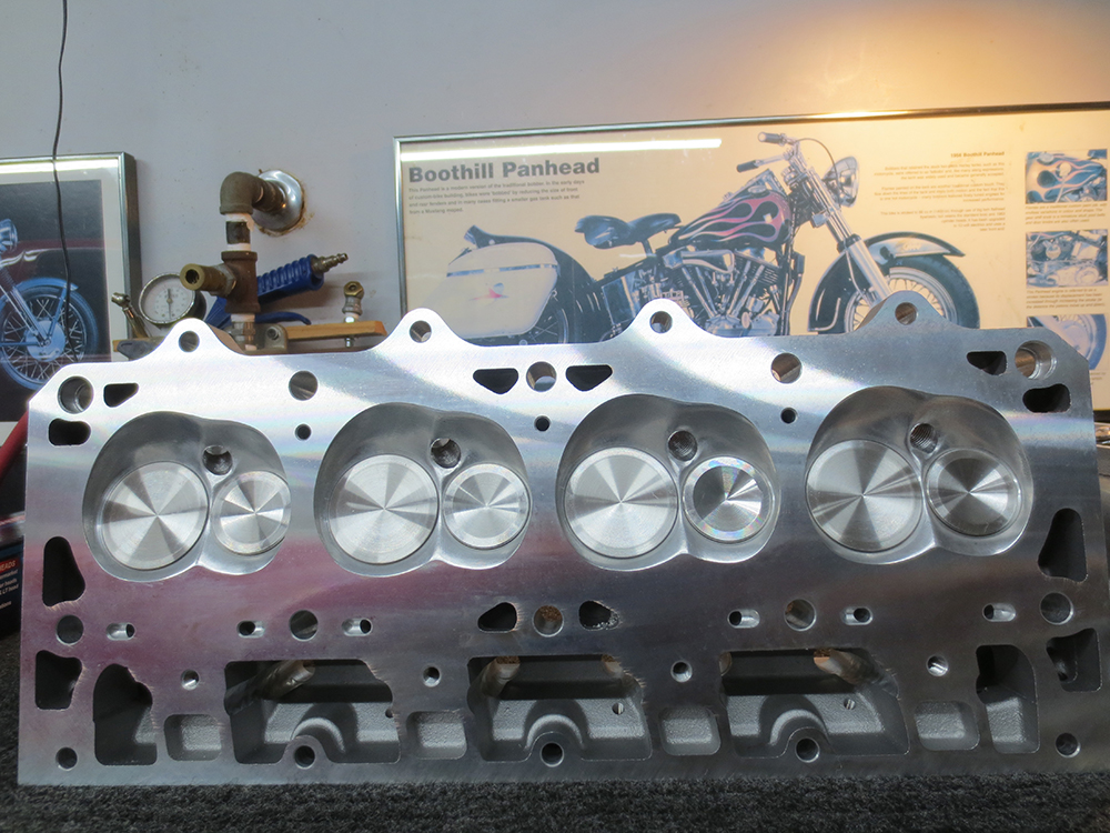

I have a set of 317's you're welcome to if you were closer, I'll never use them. I swapped for the same PRC 225's but with the smaller 62cc chambers. If it's in the budget the PRC cnc 227 heads allow for more port work (if needed) whereas the as-cast 225's do not.
Some eyecandy to help you decide
