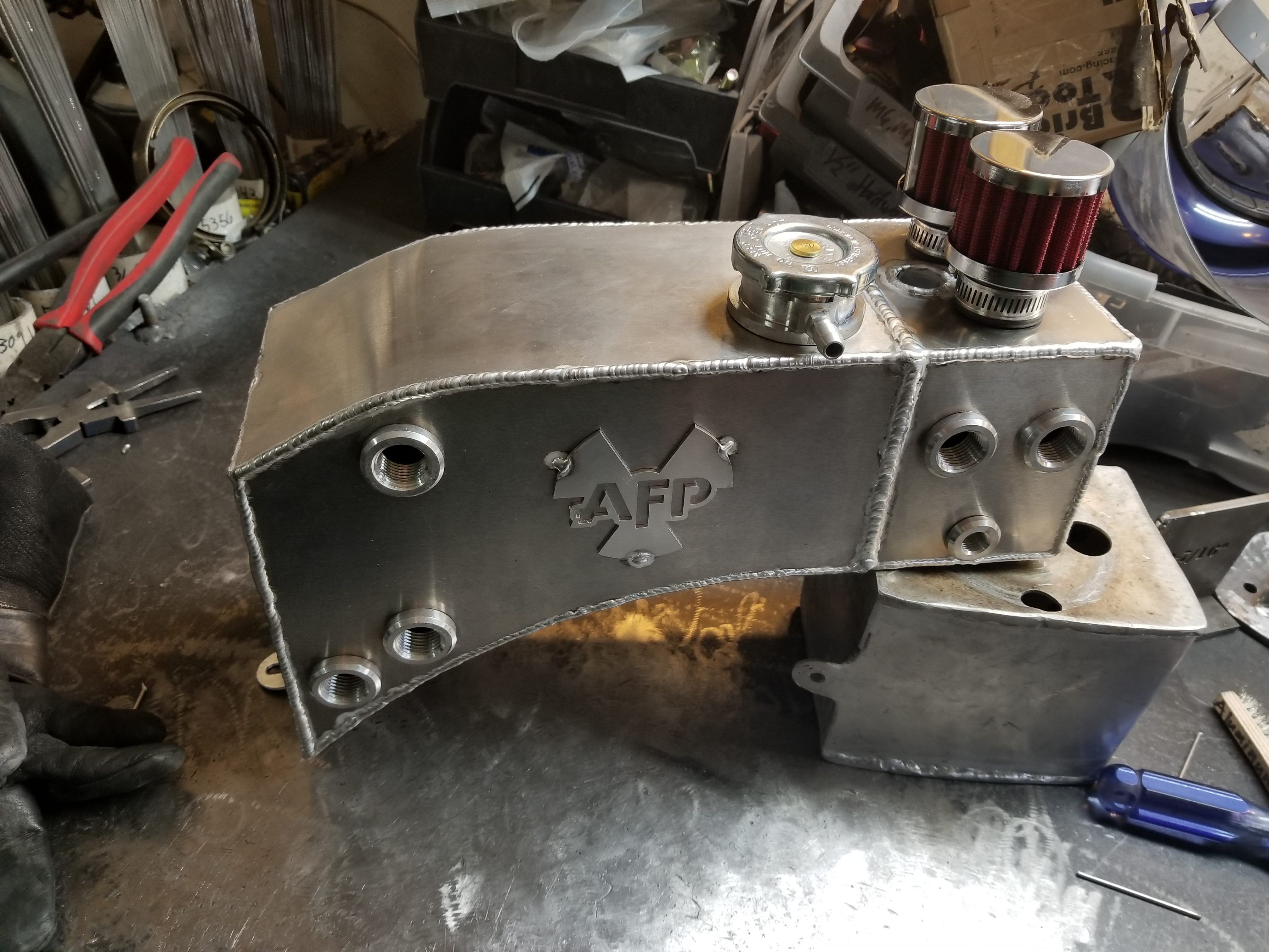

Originally Posted by Atomic
Wow you guys really struggle with this. On all my coolant tanks ive had or the custom ones I make you just fill to 3" below the top and go. Never had a burping issue or anything else for that matter. If I overfill it will puke out the excess the first time it gets hot, but never gets low enough to not keep the pump primed, unless you blow a headgasket of course.
Where can I find your tanks Atomic!? Pictures and where can I order them. I'm shopping for a new bigger tank and ditching this little Aveo tank.
Old Mar 1, 2018 | 09:22 PM
  #23
Atomic's Avatar
I have a gauge for that
Posts: 16,282
Likes: 438
I have them on my website (welded or diy kits) and also have this coolant tank breather can combo I need to get rid of I have sitting around.

Is that little tank vent hose pre or post cap?
Is it an overflow port.
Old May 11, 2018 | 10:36 PM
  #26
Atomic's Avatar
Posts: 16,282
Likes: 438
If you are asking about mine that is an overflow port, post cap.
Old May 12, 2018 | 03:38 AM
  #27
TrickTurbo's Avatar
Truck Sponsor
Joined: Sep 2006
Posts: 4,466
Likes: 62
From: Wichita Falls Tx.
No,
I was asking about that little plastic one.
