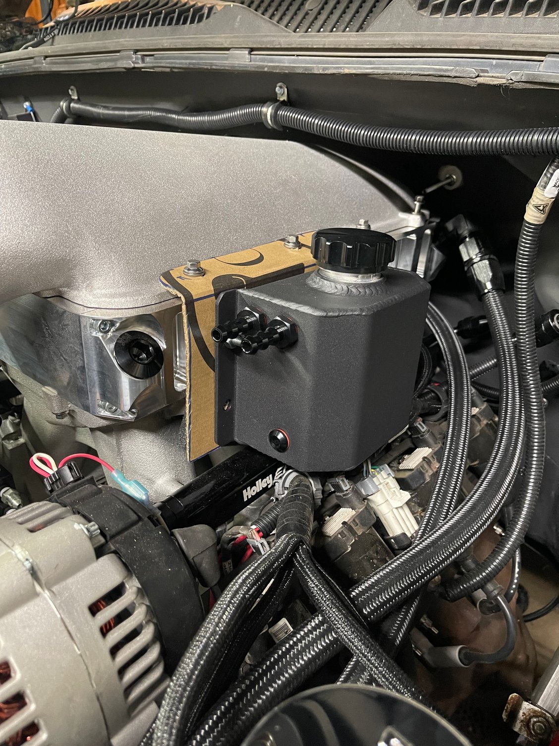

Default Coolant tank mounted by intercooler
Any reason this won’t work well

This for a over flow?

Yes it is. Intercooler tank took the space we’re the factory one used to be

You have a inline cap on top radiator hose?

Yes I do

That will be fine. Id run a hose from the rad cap to the tank. And then one from the tank to the rear of the truck incase it does blow coolant it will atleast be behind the rear tires.

My preference would be to keep it a bit further from the heat than that.
