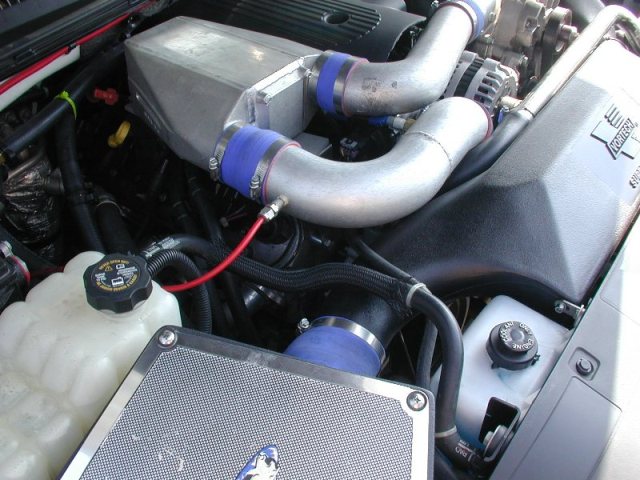

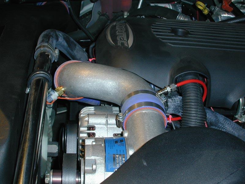

Ok guys, I have run the Stage 2 Snow Meth kit for nearly two years now on a 13 psi non-intercooled Vortech blown 5.3L with great results. The spray would knock a 160-170 IAT below 100* almost the second it started spraying....
A couple weekends ago, I installed the Vortech Aftercooler. Man, why the hell didn't I do this sooner... My issue was with timing pulls in mid-load prior to the meth spraying..... there are no such issues now with the aftercooler.
What I have noticed though, my IAT temps are now at 15-20* above ambient running around town.... my question surrounds going into boost and the IAT temps climb to about 125* to 127* at 11 psi.... I can turn off the meth kit and see basically the same thing...
What gives? why is the spray not knocking down temps any better with the aftercooler? nozzle placement? spaying into a cooler tube?
My mix right now is 40%/60% meth/water, with a 625ml nozzle on a 150 psi pump. Should I just delete the water and run full meth? I tune my own with HP Tuners on a 2 BAR SD OS, so I am aware the straight meth will require my VE retuned up top... I am also aware of the advantages of timing gains with the kit....
I just want to kick this issue around a bit and hear what others have to say...

is the iat sensor after the nozle still.
if the iat's are not droping i would really question if it is working.
looking at your pic's is that the sensor on the inside corner after the intercooler and nozle? if it is there is a chance all the meth is just being pushed to the outside of the corner and not hiting the sensor.

As I said in the original posting I fully understand the benefit I receive from the meth/water injection as it pertains to timing/boost. I would not have been able to run 13 psi at 22-25* timing on a daily driven truck making 650 hp for two years without it....... on 93 octane.... in 100* Florida heat. I tune my own truck so it is hard not to understand the benefit....
back to the question at hand.... I thought about the airflow when I relocated the nozzle and sensor in the aftercooler. It is pretty much the same setup I had prior to the aftercooler install, the difference being one additional elbow in the intake tube due to the aftercooler.. attached pic shows the before and after locations of both nozzle and sensor...
I agree I should be seeing IAT drop... I have for two years.. that is what is making me nervous.. I am used ot seeing this setup drop 60* instantly....
I am replumbing the intake to the blower next weekend from the CAI... I might try moving the IAT sensor to the outside of the pipe across from its current location....
