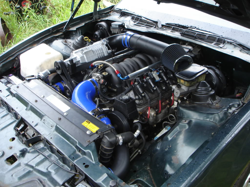

I did a sidemount M90 fab on a stock 5.3 and it was pretty potent over stock, but it did fall off up top. Saw 4-5psi down low, dropped to 0psi around 6500rpms. By then, the engine was out of breath anyways. The instant torque and flat power curve made the measly numbers potent on the track against other modded LS1s
M122 came on the newer ford GT500's
I did another build using a LQ4 and a M122 with much better results. Pushing 11-12psi with it
