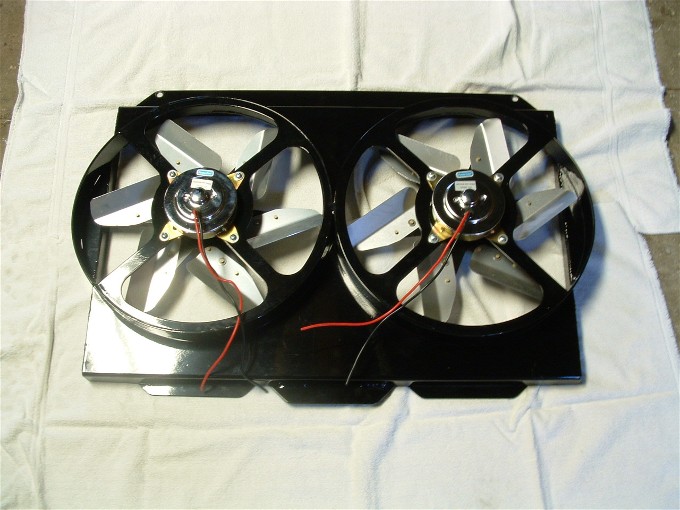

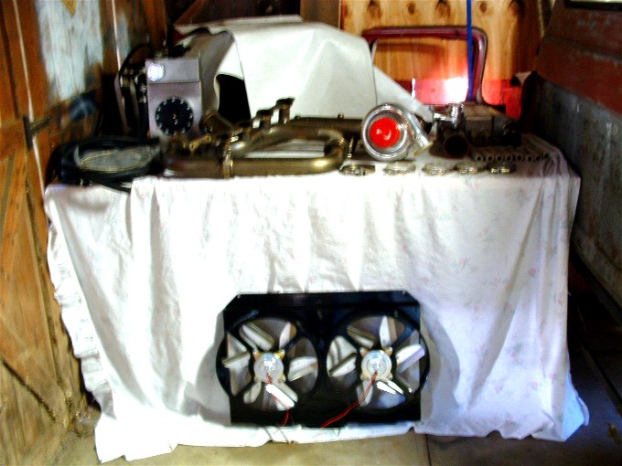

There are a few pieces not in the pics, but you get the idea.

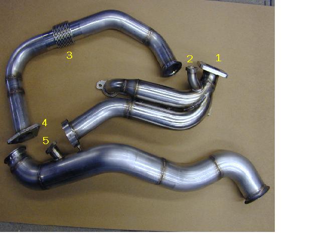

I was gonna actually get in touch with you when I got closer to being ready to start something. But since you came in, I'll ask a couple things now on the pic of your setup here.....some of the things I marked I'm pretty sure on, but if they're labeled wrong let me know.
1. Turbo Flange
2. Wastegate Flange (?)
3. and 4. Not sure on these
5. Wastegate dumping back into the DP
TIA

Build it your self if you have the time and money.. I built mine using the same manifolds, and exhaust the truck comes with.. The intercooler and charge piping took alot of time the way I ran mine.. Not sure what the final power is but damm its fun driving, especially on cool mornings. Things falls off a little over 100' air temp outside.. These pic are while I was prototyping the kit out, I am in the process of building another one so everthing is dirty. sorry about that...
