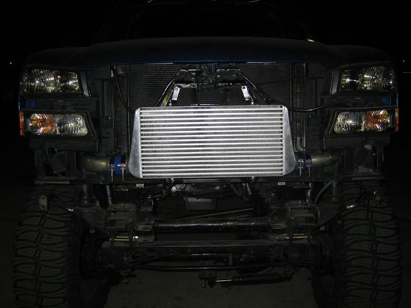

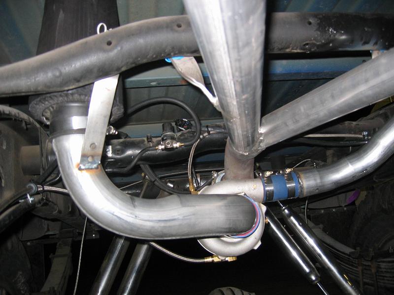

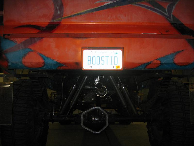

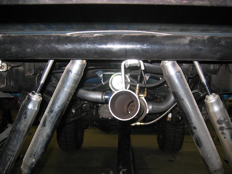

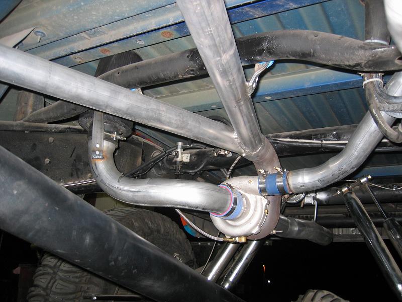

Just Got the truck running, not tuned right yet but getting there. GT67, 42lb injectors, walboro pump, diamond pistons, balanced motor. Here are some pics.

looks good i built a turbo set up for my bosses 87 gmc very similiar to how you got yours underneath the bed of the truck...just using exhaust pipe..what kind of oil pump do you have?? do you have a timer of some sort to run the pump a little bit longer after the motor has shut down?

The pump is the one that STS uses. I uses a greddy turbo timer.

I like how you get to see the business end of turbo when looking at the back of the truck.
