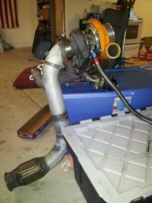

Default Finally got the turbo back
I upgraded to a 46 mm PT waste gate and relocated it and the boost creep is finally gone so Off to the dyno again soon. Heres pics of the original setup and the new one.
