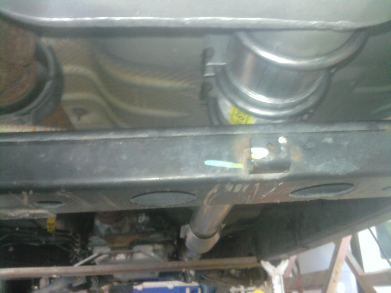

Started a week and a half ago on the build once I had most parts standing by. This is an 04 with a 3.5L I5, Garrett GT3582R turbo, Precision turbo 39mm wastegate, Greddy Type RS BOV, 60lb injectors, full 3in exhaust w/a Dynomax VT muffler and a magnaflo cat, looking for a 350 or better at the wheels and maybe 2 months down the road I have forged rods and pistons just have to get head and cams reworked but here is the setup now.

The turbo is .70 A/R and 82, I'm registered in MN so a cat is required but now one really cares but this cat is not really restrictive I couldn't even mail it to CA I had to send it to a friends house in NV, and there is always that option of V8 but I actually like this engine and a v8 wont make the MPGs this will, not to mention v8 swaps are a pain it *** I did one on an s10 some years ago, and they take alot longer more expensive.
