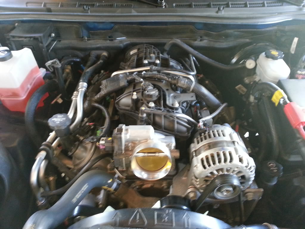

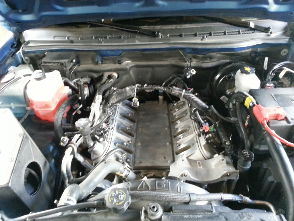

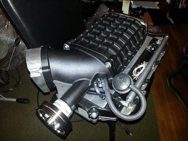

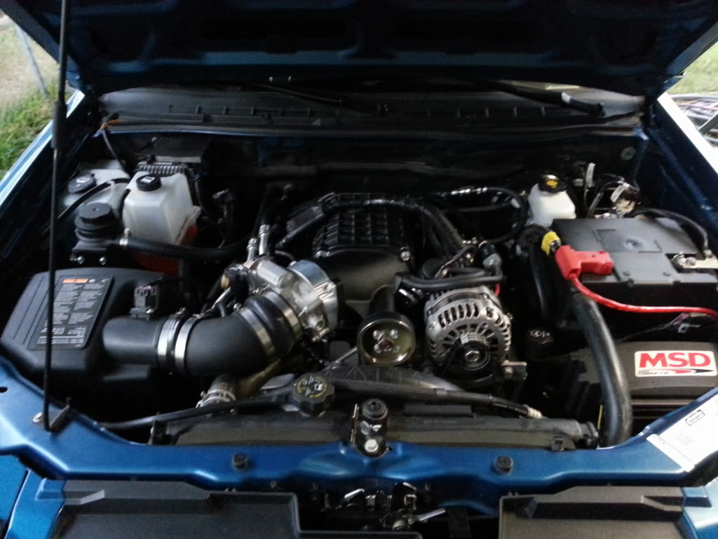

Well I installed a tvs1900 on my colorado v8 5.3, hell of a deiffrence,,, getting an electric fan and dyno tuned in a couple iof days,, im wondering if i should swap out to the next smaller pulley to get a bit more boost,, here are some pics and a quick video

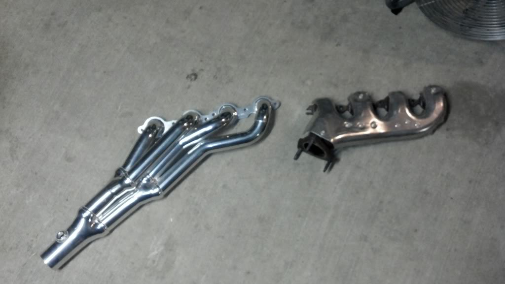

What long tubes?
Old Dec 4, 2012 | 11:35 PM
Hotrado's Avatar
Joined: Apr 2012
Posts: 38
From: Houston
Originally Posted by smokeshow
What long tubes?
doug thorley tri-y headers

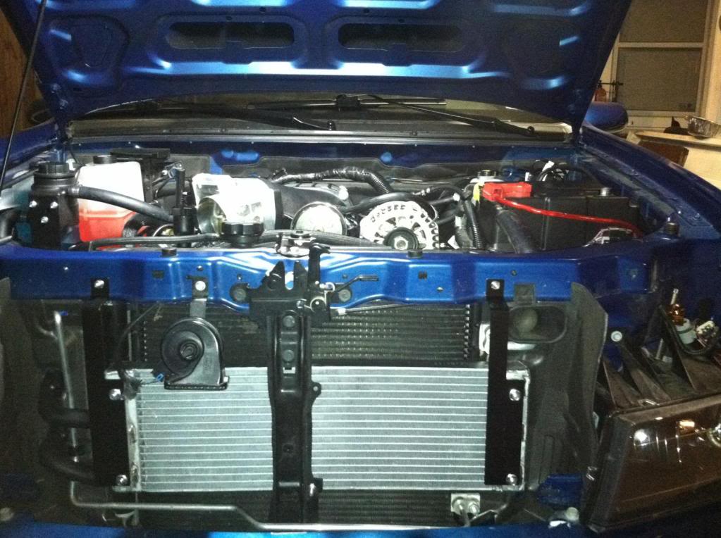

Wow this thing has to be sick. I know the biggest complaints with these are iats getting out of control. A larger heat exchanger and other cooling help would be a good idea. If you are going to use a single efan then make sure you build a good shroud and make sure it has good capacity. Especially before you pulley down.
