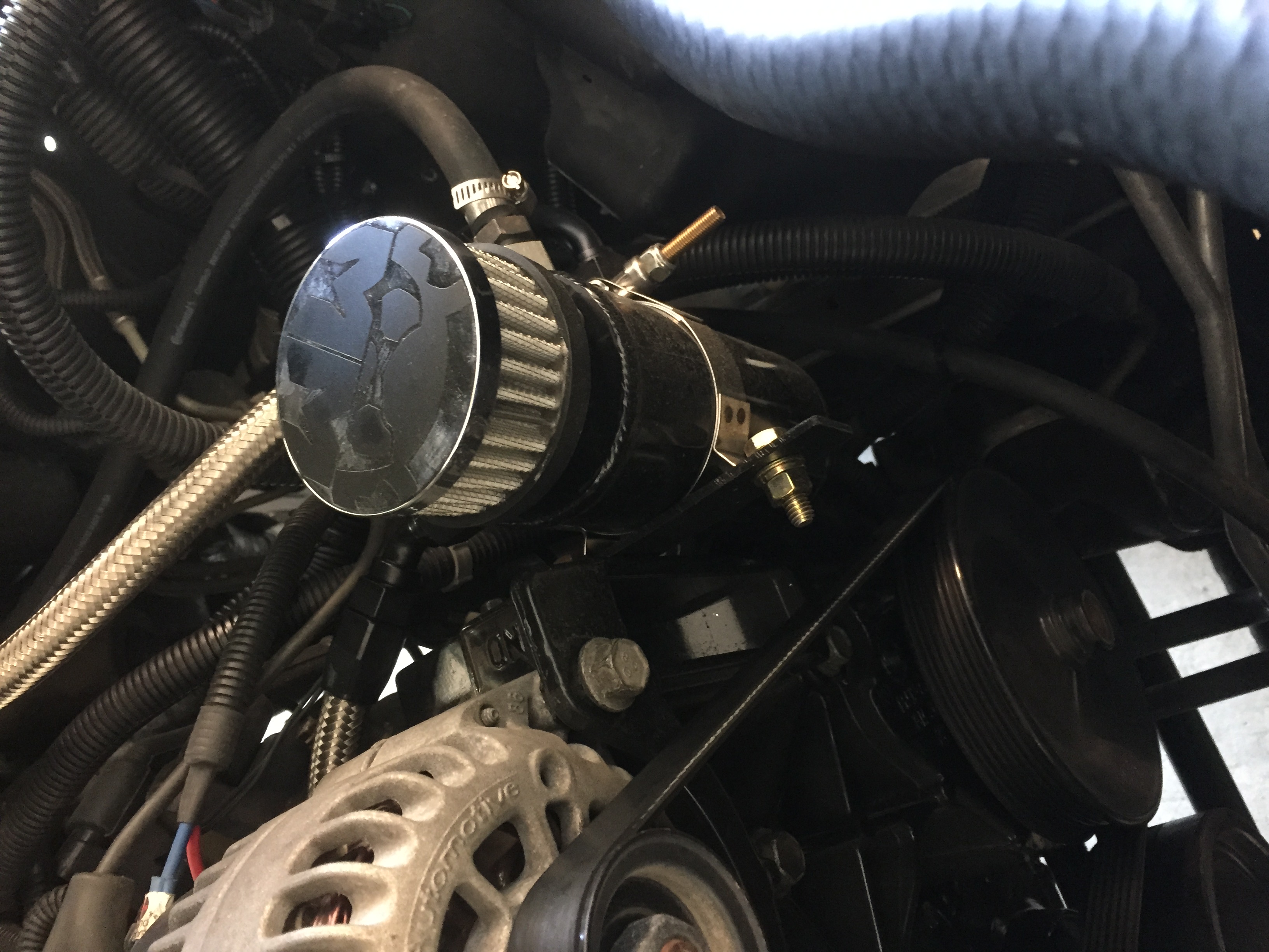

I have a MM pcv can that I decided to just vent both valve covers to atmosphere. I have about 1200 miles on the new motor and setup. The first 100 miles getting the motor broke in I had a small break in smell. After that I have never smelled any oil. I did run a vacuum line to the can do the crank case would have some vacuum on it out of boost.
I ran 2 #8's from the valve covers to the can also.
