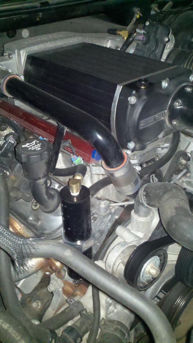

I went with the one stated above. Plus, it looks good and gets the job done.catch can questions-catch-can.jpg Yes i know its dirty.
