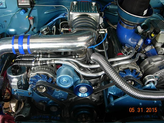

I just put in a monster rx catch can but I am going to change to venting both valve covers to it ....
1 hose goes to throttle body...has a one way valve...
1 goes to supercharger boot input side, has a one way valve...
1 goes to valve cover with other cover with a breather..

If you run both your valve covers to the can, how are you going to run your third line?
Old Jul 7, 2015 | 05:54 PM
Joined: Jun 2012
Posts: 89
I will tee in the valve covers to the middle line...fittings on order will post pics
