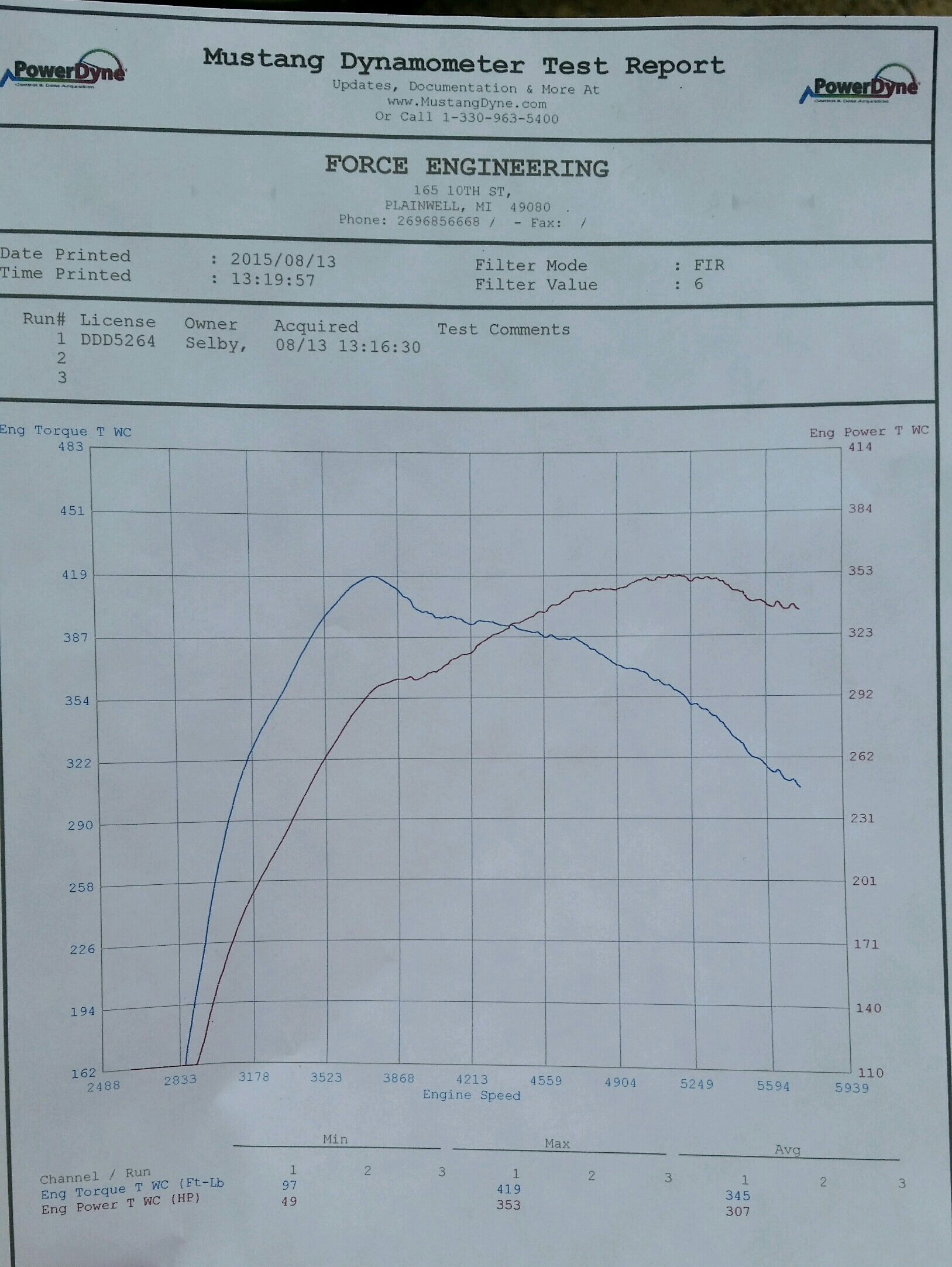

dyno results came in
so here is the break down
tvs1900 and 3.4" pulley
rancho 4" lift
moto metal mo962 18" wheels
nitto trail grappler 285/65/18
ottp 1 7/8" long tubes
true dual 3" exhaust
transbuilderguy.com level 5 4l60e good for 800hp
353rwhp and 419 ftlbs on a mustang dyno

It's weird that the dyno isnt scaled the same on HP and torque. That was throwing me off a little.
How much boost do you run? Is the 3.4 pulley what the maggie kit came with?

it throws me off a lot to.. i would have thought 400hp 420ftlbs or 400hp 390ftlbs.. its weird for sure.. im running 7psi, the stock maggie kit came with 3.8 pulley for 6psi

You have the exhaust in place to really make big power. I'm surprised that its not pulling higher in the rev range, but that's the factory truck cam for you.
A cam swap with slightly more pulley would add more power than the blower alone...
unfortunately my stock fuel system will not support much more of a pulley.. guys with similar builds have had to upgrade pumps and injectors.
