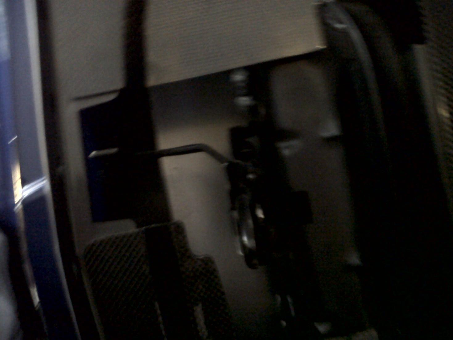

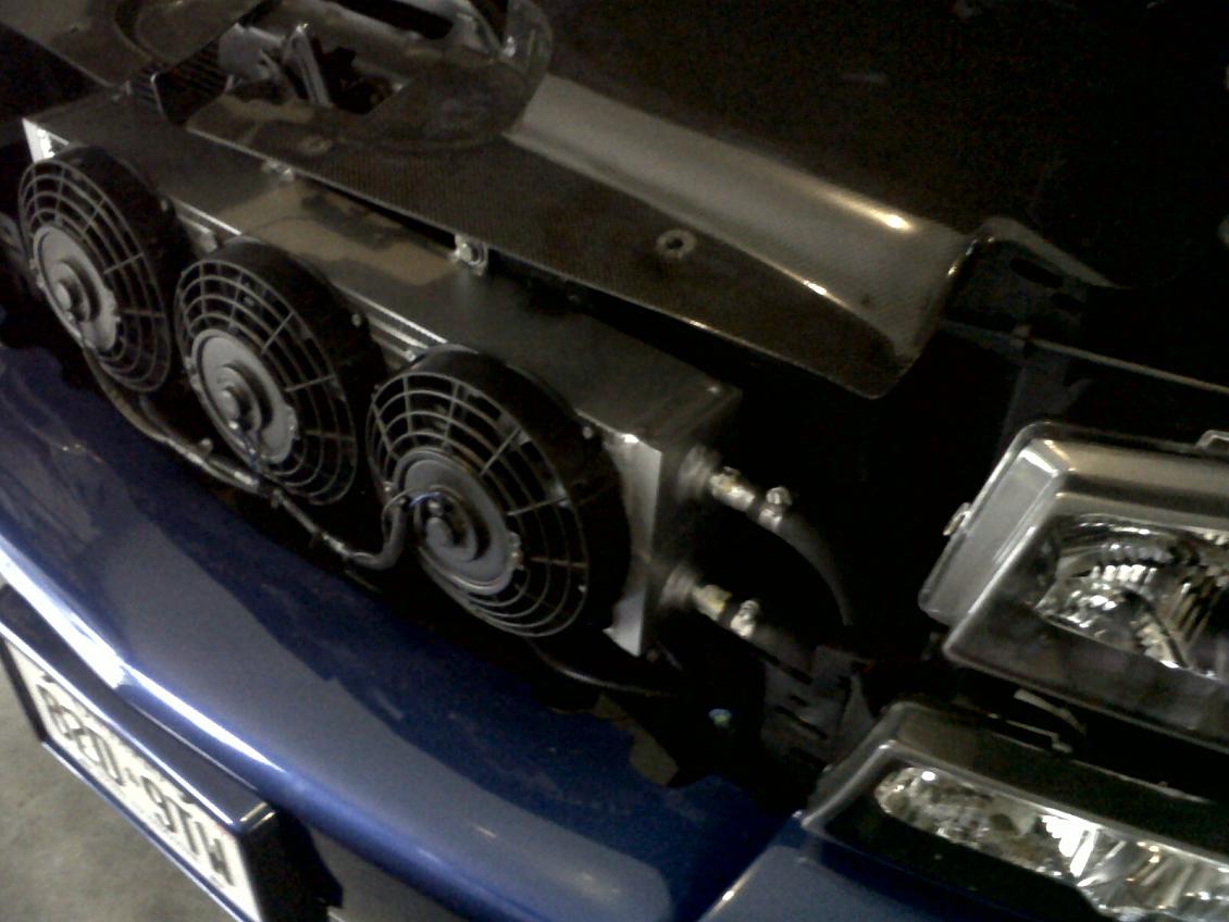

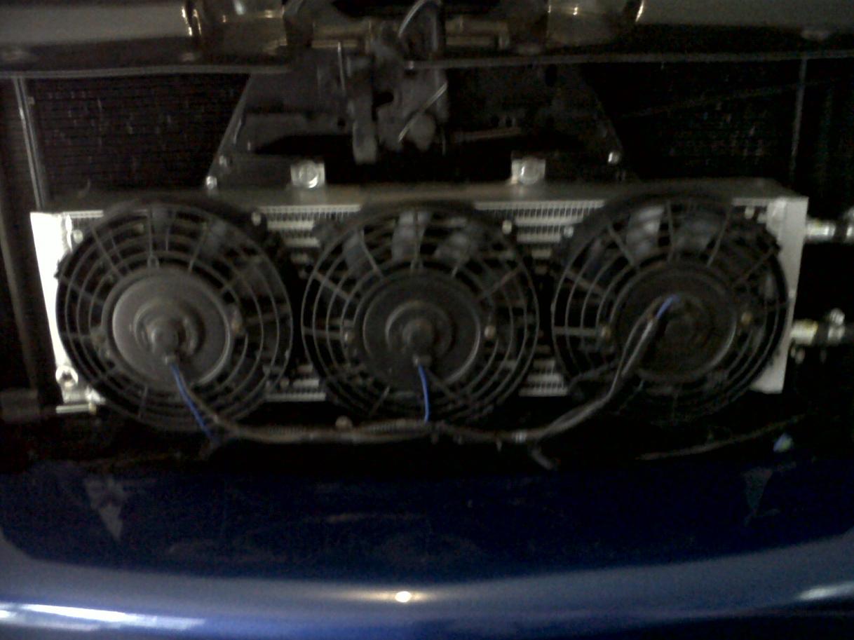

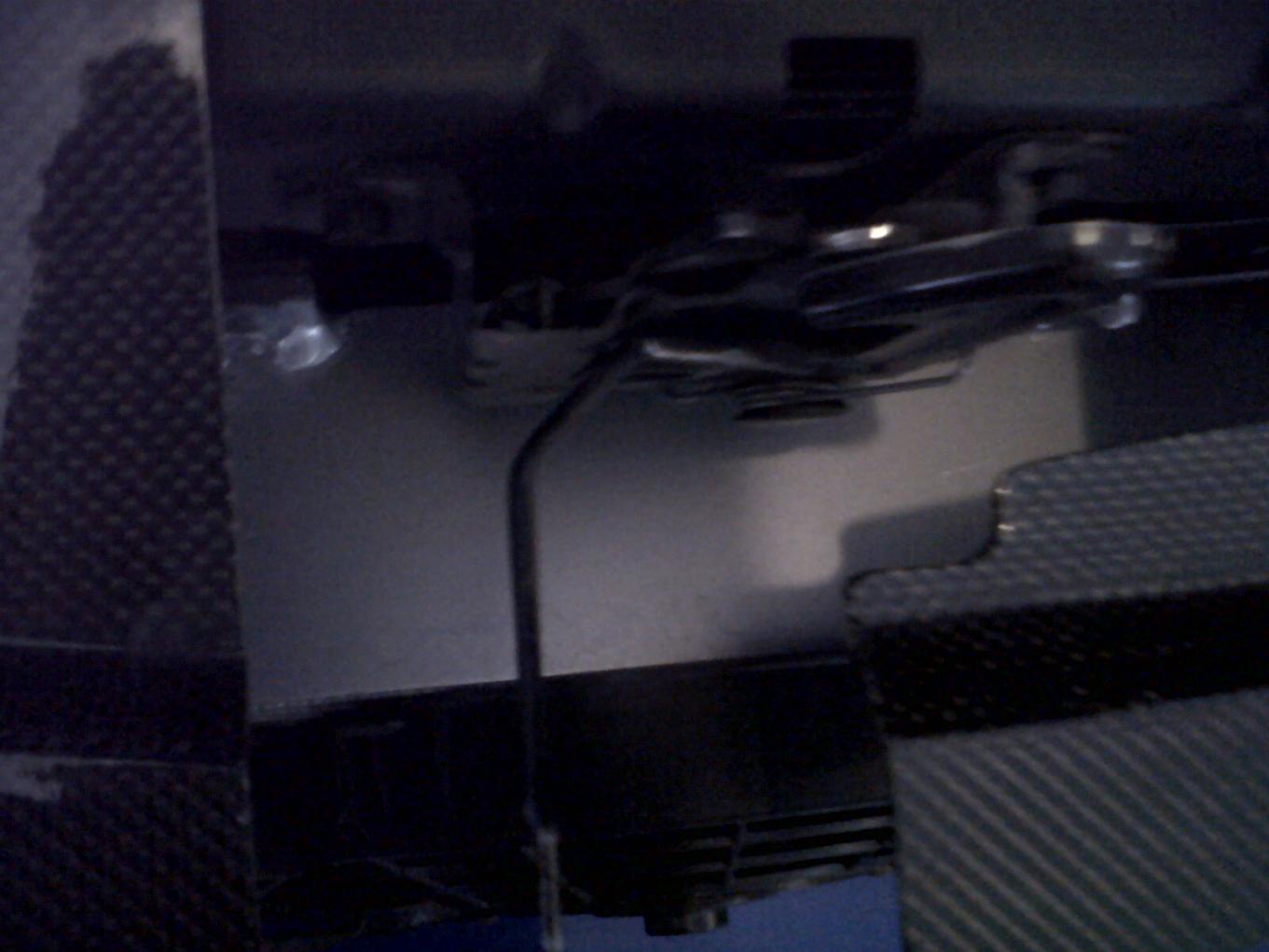

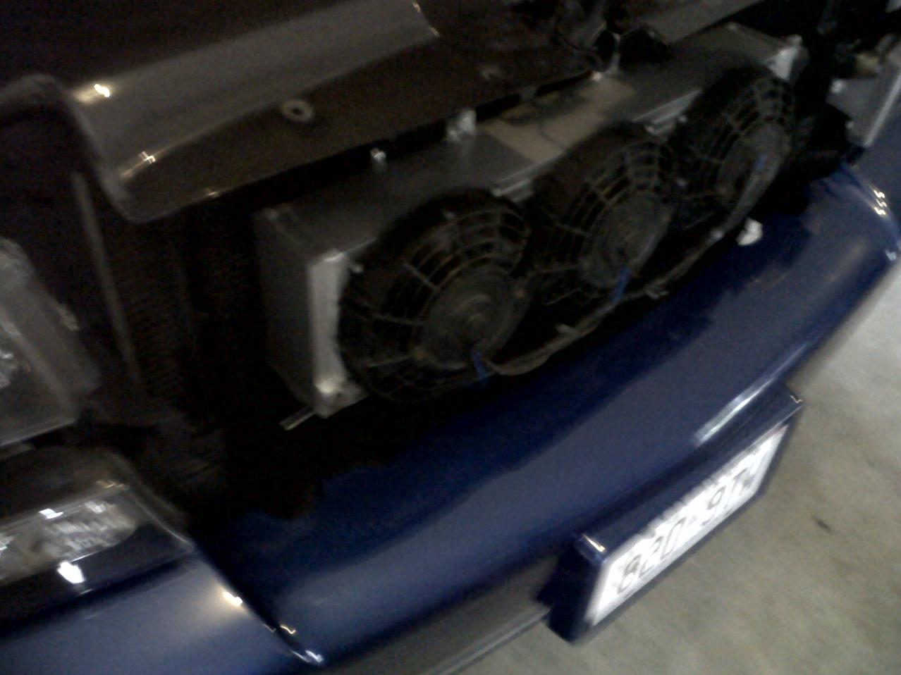

I have this one on my truck with e-fans wired to a switch in the cab. It fits behind my grill but my tranny intercooler was already re-located where the bumper is
heres some pics
