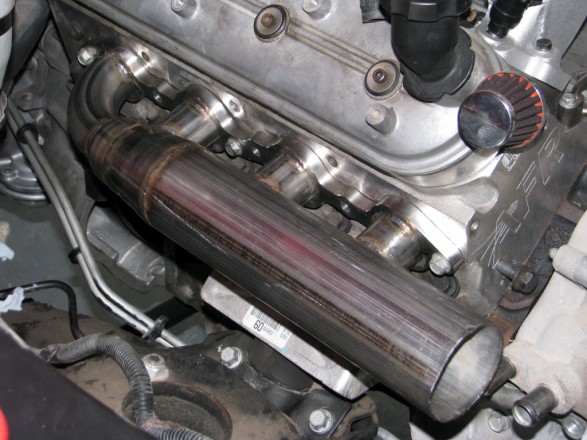

Here's one I just did if it helps with ideas.
These pieces feel strong and won't bend.

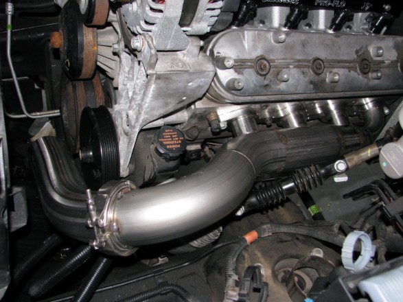

I made the headers for the turbo system for my Chevelle out of 304. My headers arent completely done in this pic, but you get the idea.

those look pretty good^ did you back purge?. there is a cryo treatment guy around here. i want to get my manifold cryogenically frozen , he said it helps alot in the strength department!!!
