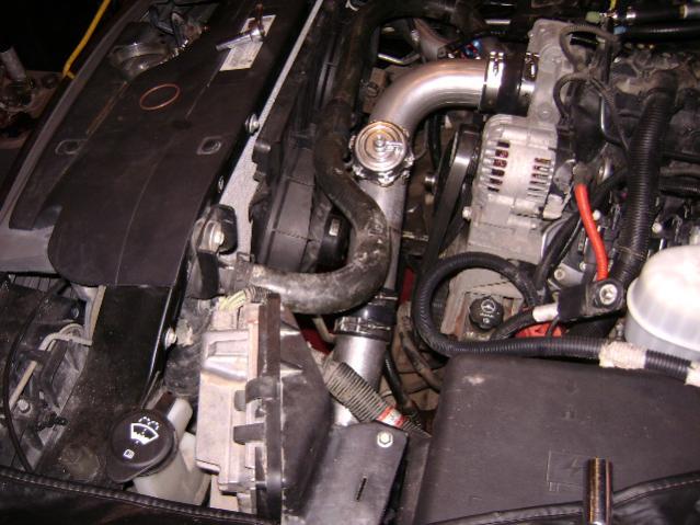

Are you connnected to the top port, where the barb fitting is mounted in the pic? What port are you connected to on the wastegate?

Yes I am connected on the top port, my BOV actually looks exactley like yourse. What kind is yourse? Did you mean what port am i connected to on the intake manifold? If so I actually just took the vacuum line off that goes to the fuel pressure regulator, just to make sure it works before i drill into my intake. There is plenty of vacuum coming of of that at idle.
Is there a certain size line i should use? mine is pretty small right now, what size are you running?
