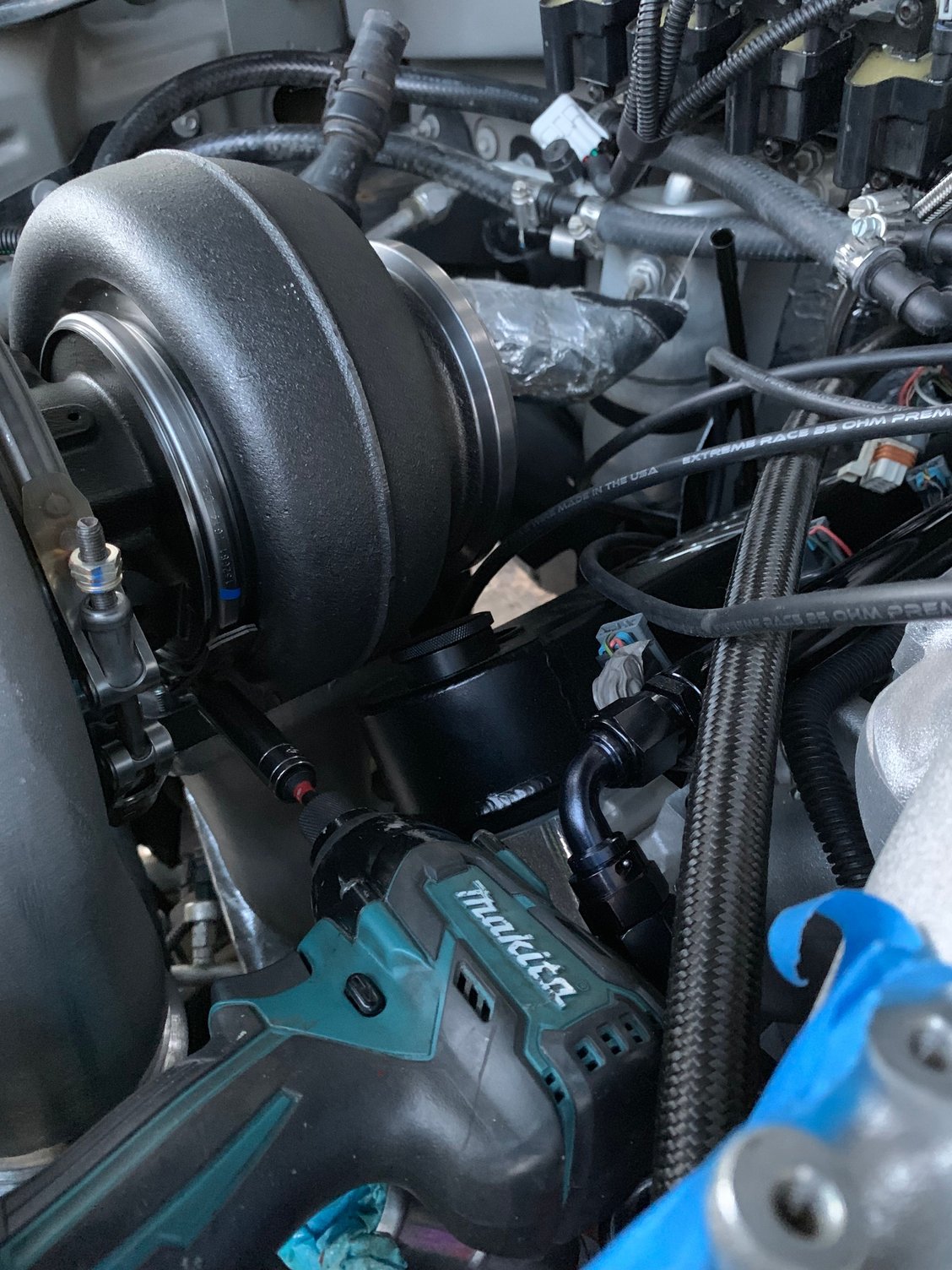

Anyone who running big turbo borgwarner with aftermarket tall valve cover. I got all set up t6 kit from trick. It’s hit oil cap i can’t fill up oil. What other i can do. Can’t change to stock cover because of big valvetrain roller rocker arm yella. How about driver side drill it and ASAP oil fil. It’s hard to find oil fill kit. Can you help me. You

You can't put the that valve cover on the drivers side?
That would seem easier than drilling and taping it.

I could switch to driver side but fill up it would be back of fire wall. I need front one

How often are you filling oil? Not necessarily bad to have the oil fill in an inconvenient spot considering how infrequently oil is added...unless you have other problems.

Pour oil into the driver side head then put the cover on afterward.

I would just swap them from one side to another. I have LS9 covers and with the taller aftermarket heads I just barely have enough room to get the oil cap off. Problem is that there just isn’t much real estate in that area once you have a Large frame T6 in there.

I used a flange as a spacer at one point

as simple I finish order filler bung Ill drill on driver side valve cover and tig it up.
