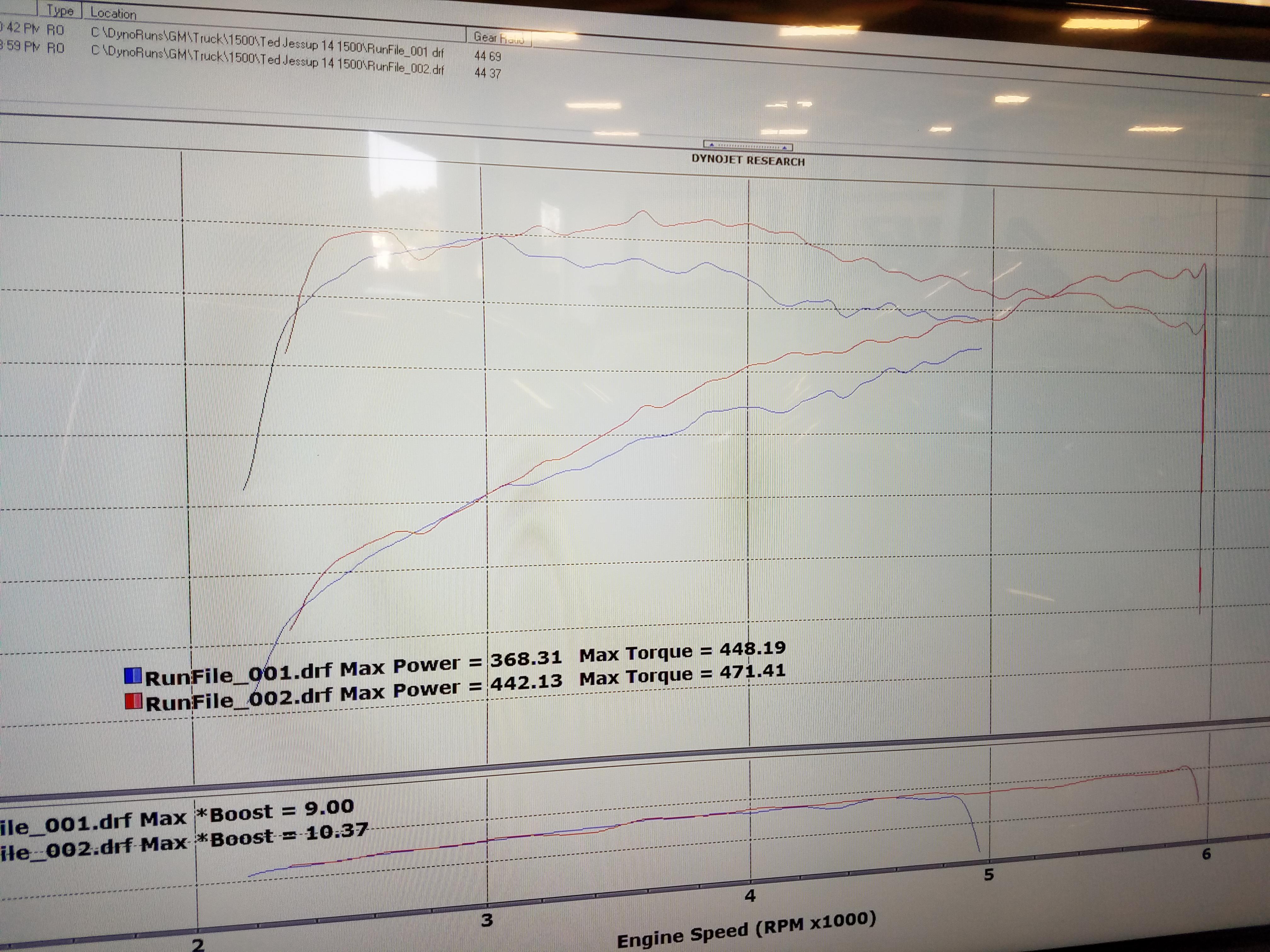

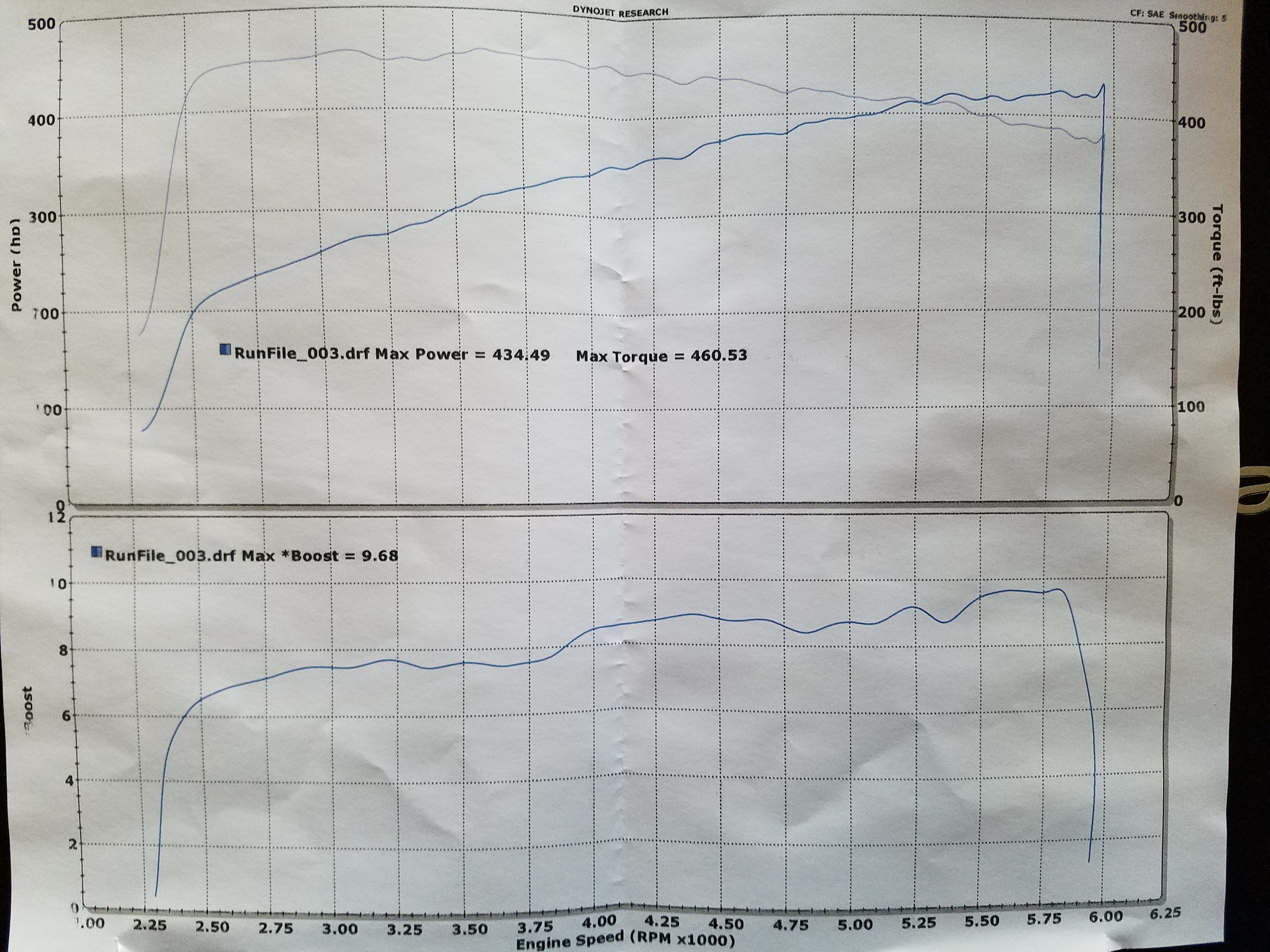

Today's results. Sorry for the first pic. Took it off the dyno screen. Sam at AMP said the 1st pull with the Whipple tune would've resulted in ~ 400 whp had the speed limiter let it wind out. Second pull was 442 hp & 471 tq with it cooling off for 15-20 min. like I would do at the track. Torque under the curve was a full 60 lbs more at the widest point after tuning. Boost was 10.37 lbs. Third pull was only 434 & 461 a few min later like it would be driven daily and boost was 9.68. 4th pull was even less so he changed timing back to before last pull. Don't guess Ill be changing pulleys after all. Exhaust must be very restrictive. Truck is extremely responsive (as if it wasn't before). Still evaluating part throttle and getting used to it. Feels a lot stronger and I'm very pleased with what Sam did. Great guys, Sam and Bryan.

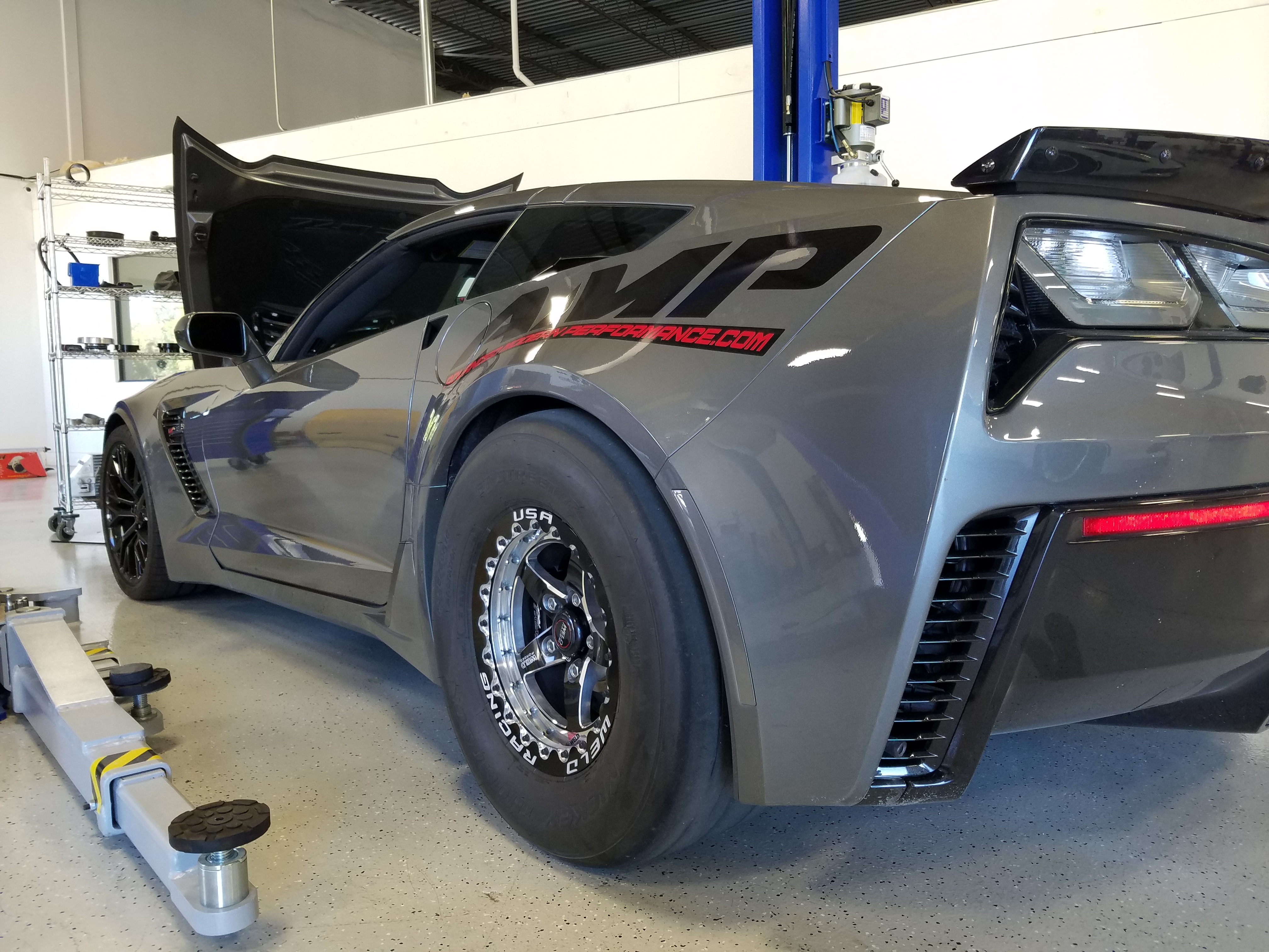

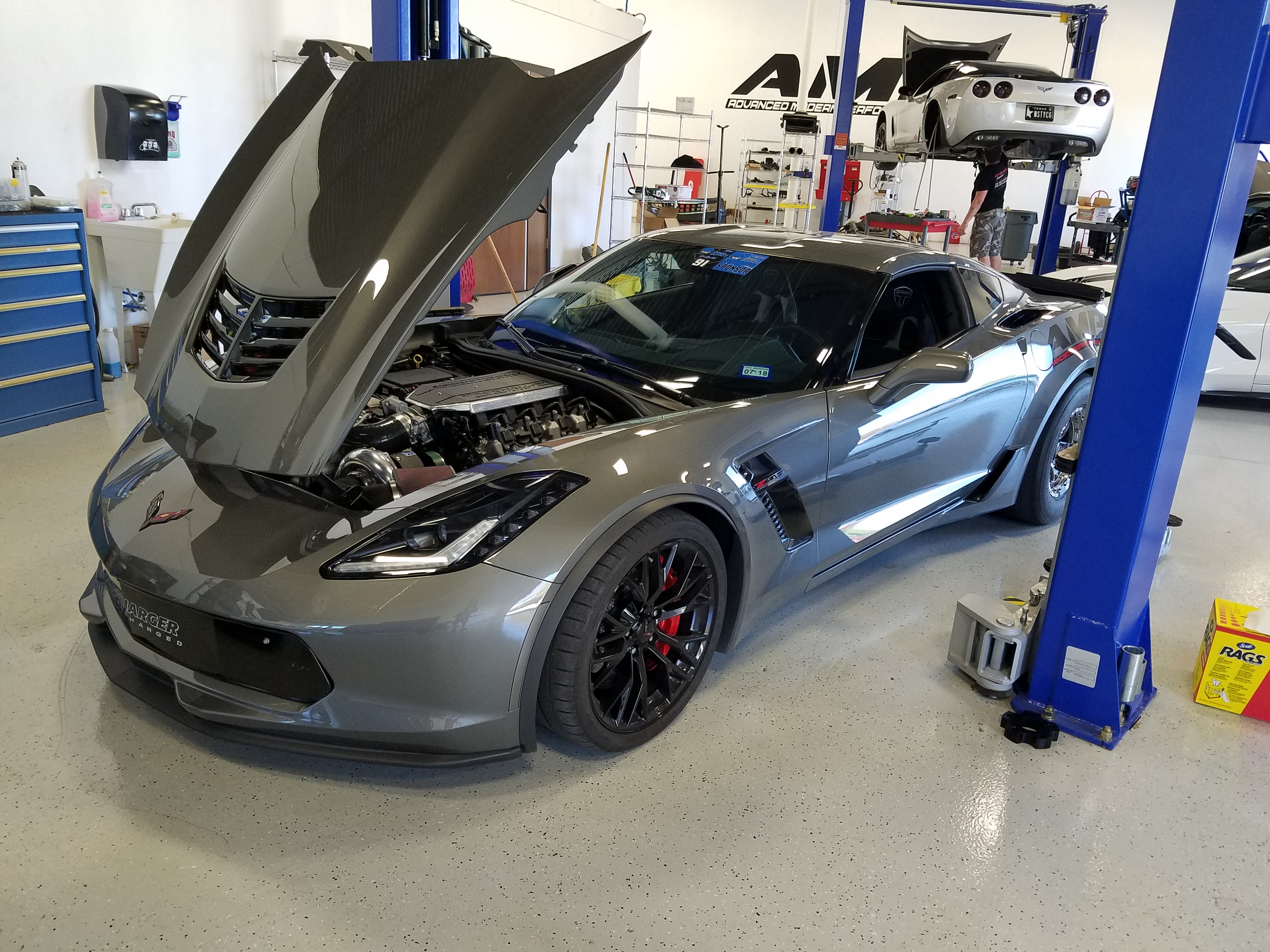

A little eye candy while I was waiting. Sam's F1x ZO6 1300 whp. 1st C7Z in the 8's.

So how much was the gains? did they do tranny tweeks? how do you explain all that boost?

~40-45 hp and 23 tq. Yes on the trans. Gotta be the restrictive manifolds and exhaust. I was quite surprised.
