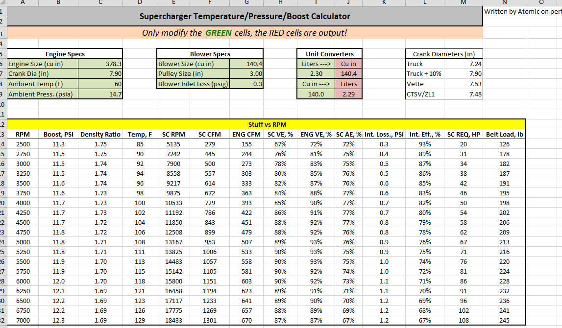

Old Apr 16, 2018 | 11:37 AM
Atomic's Avatar
I have a gauge for that
Posts: 16,282
Likes: 438
See pic. About 11-12psi.
