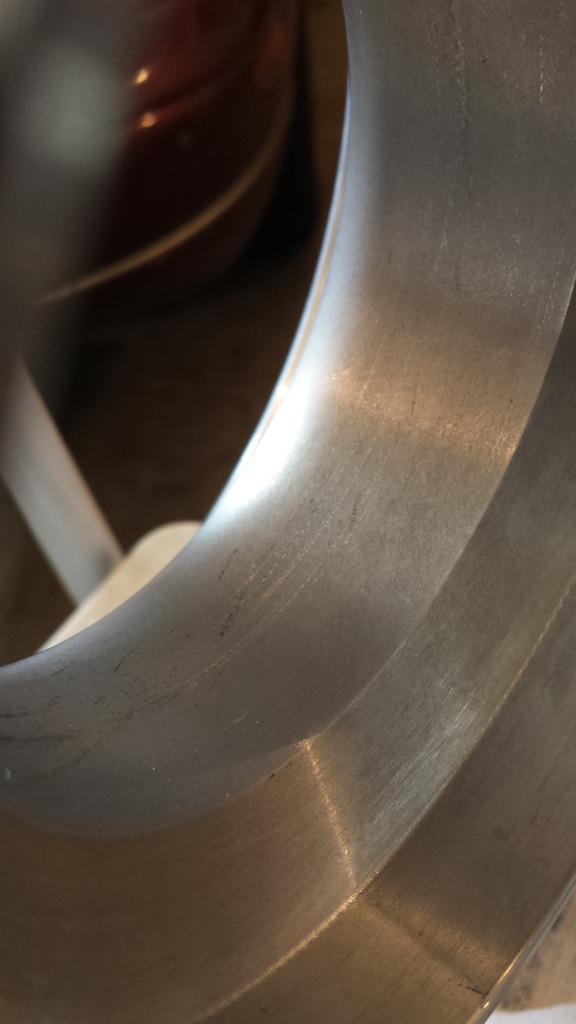

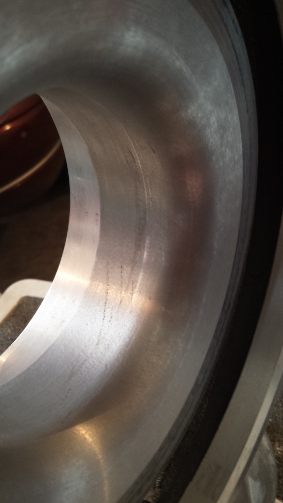

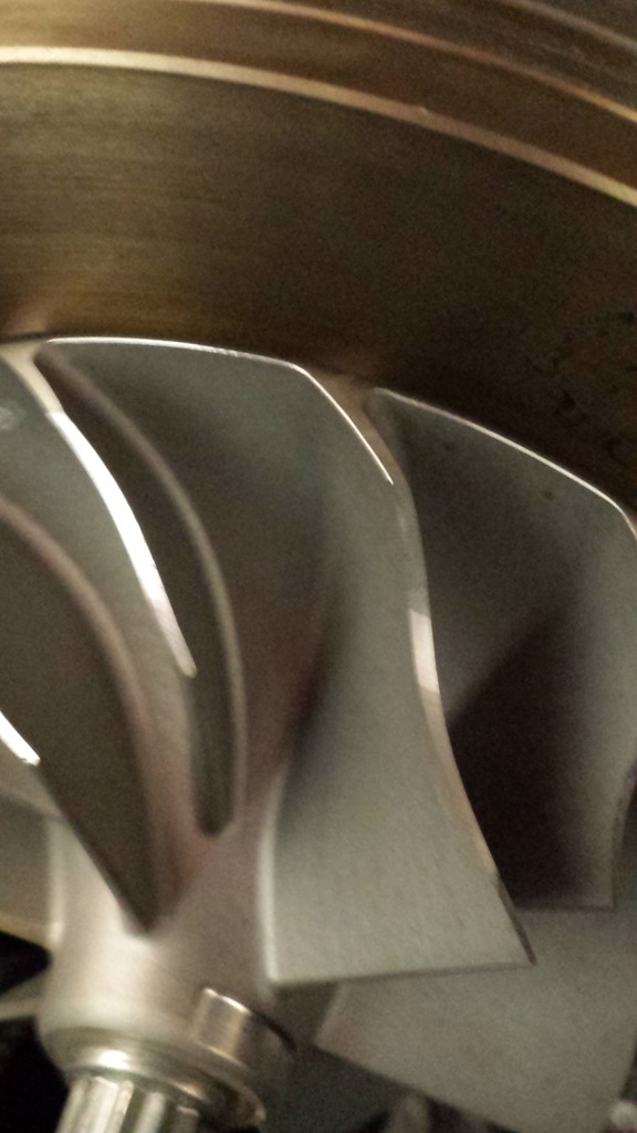

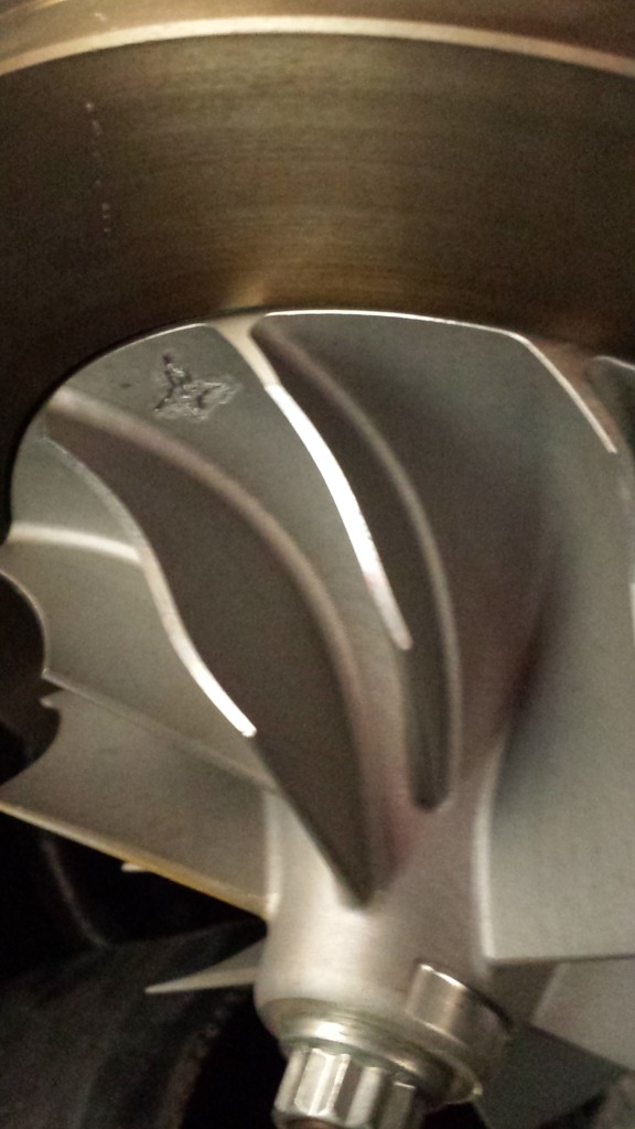

From: Ankeny, Iowa
What do you think? There's a couple fine little marks on it but nothing you can get your fingernail on. There is some shaft play up and down but nothing back and forth. I'm not sure if some of those are from machining or not? I had this off another time and can't say if they were there then or not? Nothing in the silicone hose on the outlet for debris/dust.
Old Sep 26, 2014 | 02:56 PM
  #26
boostedsl2's Avatar
Joined: Jan 2005
Posts: 357
From: St Petersburg, FL
Looks fine. Its not touching. it would be really obvious.
guessing you've got a vacuum issue if its still happening.
