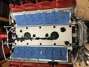

Originally Posted by smokinlmm
I was told I couldn't run this??? Is that true? If I can I will add it when I do the new top end...
It won’t clear on a TVS without getting creative.
Attached Thumbnails Big HP guys come on in (700whp+)-397229b3-9d67-4f00-8c50-5a108ddabab2.jpeg

I see that. Thank you!
