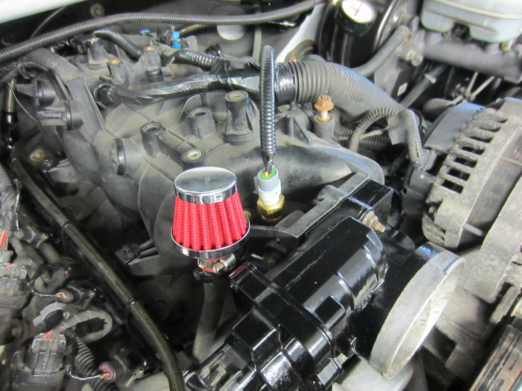

Obviously pressure in the crankcase isn't good. It's just something that happens.
Sounds like that's most of my problem then, PCV isn't blocked in boost.
I've got my breather off the pass side like this.

I just ran breathers off of both valve covers. One I ran a line off of the passenger side valve cover hose connection to a breather. Then I just bought a 5/8" (or whatever size the stock pcv valve is) breather to stick in the hole on the drivers side cover. Obviously not the best to suck out crank case vapors like stock vehicles do but it works like a sex dream.

i just run a vented catch can off of the factory pcv valve spot on the valve cover. no other breathers. i have no issues
