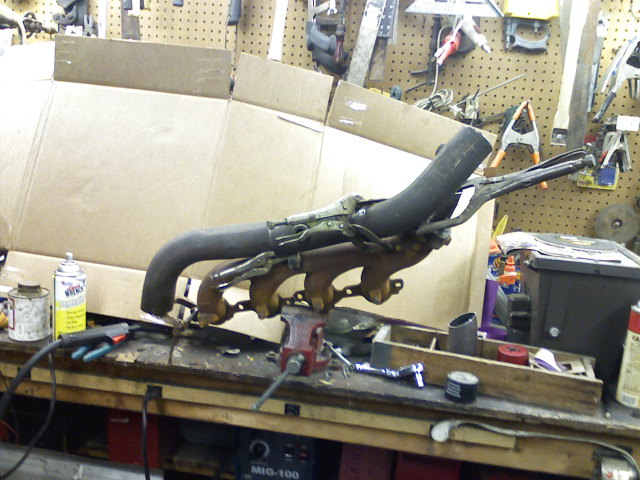

OnyxSilveradoSS's Avatar
Joined: Dec 2003
Posts: 1,069
From: Detroit
here is where I am at, I know it looks like crap...but the price was right
Driverside manifold, then crossover running along the top merging into the flange. I was going to cut a T6 but I think a MP would fit the budget better. I am going to use the heat shield bolt holes to mount it together, then wrap it in black tape

Old Mar 4, 2009 | 10:28 AM
kbracing96's Avatar
iTrader: (26)
Posts: 9,485
Likes: 31
From: Oakland, OR
Ya, Dan asked about doing like the F-bodys do, and that's forward and down. Forward and up they fit with some relocating and heat shielding of the coils, but personality, I don't think it looks very pretty. That's why I did it the way I do it, To me it just looks a lot cleaner.
