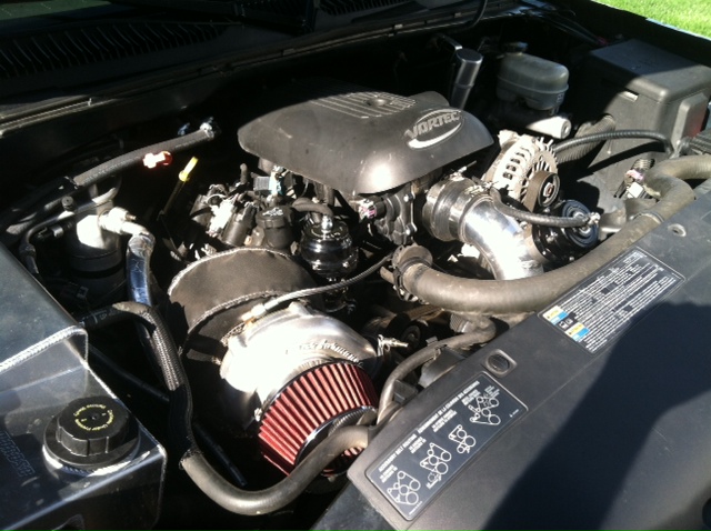

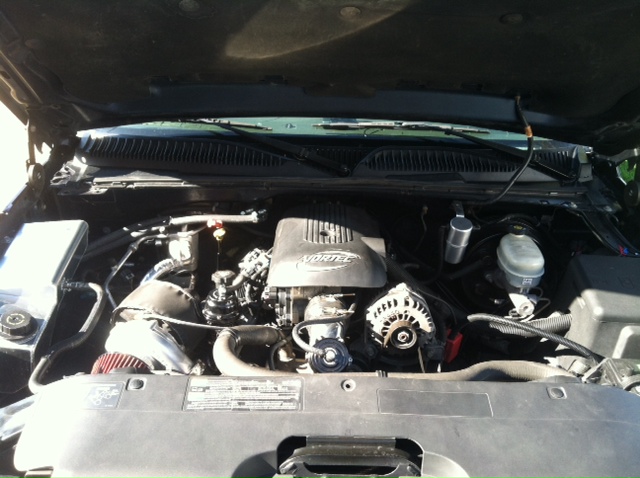

Well my On3 kit is done and tuned, drove it yesterday and today I put roughly 200 miles on the kit. I'm running on stock transmission so I've been running it between 5-7psi whenever I'm on it. I did have it tuned to run 12psi, it definitely moves out in a hurry but the trans isn't too kind at that boost level. It will shift but just slips a bit. I'm not to worried about that as I will have to replace it sooner than later.
As far as those purchasing the kit in the future, I would ask Chad to make the necessary changes that some of us had to deal with. Most importantly the downpipe, the cut I made and the clamp I was sent worked; however, on the way home last night from the tuner the two came apart. It honestly sounded better to me but I ended putting it back on and spot welded it in place for now. The wastegate is not fun to put on but at least there is a flex pipe to work with, I replaced my V-Bands that came with it. I could do it again now that I've figure it out takes some working with.
As far as supporting mods here is what I did using PT.net for most of my guidance.
ARP head bolts, Felpro MLS gaskets, ARP manifold bolts, 2010 Camaro sealed catch can w/ inline checkvalve, Moroso Mustang Tank, LS6 Valve springs, AEM IAT, AEM Truboost, TTS gauge pod, Diamond Eye Duramax cat back, Trick performance oil plate, Ceramic coat/titanium wrap on manifold and DP (would skip the ceramic coat and just do wrap), 3bar map by DSX, SD tune, 6.2 flex injectors
Overall I'm pleased with it, I believe it is still too early to tell on reliability for the turbo.... I plan to drive it 80 miles a day so it won't be long to find out for sure. Most of those miles will be out of boost though.
I haven't had a chance to clean up the engine bay but these are pics from today.

How'd you deal with the plug wires? Also any dyno numbers?

no dyno tune it has a street tune, tuner says around 450, it pulls really well, boost comes on pretty quick.
I'm using Corvette wires with sleeves.
