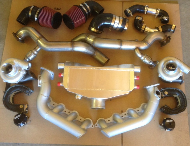

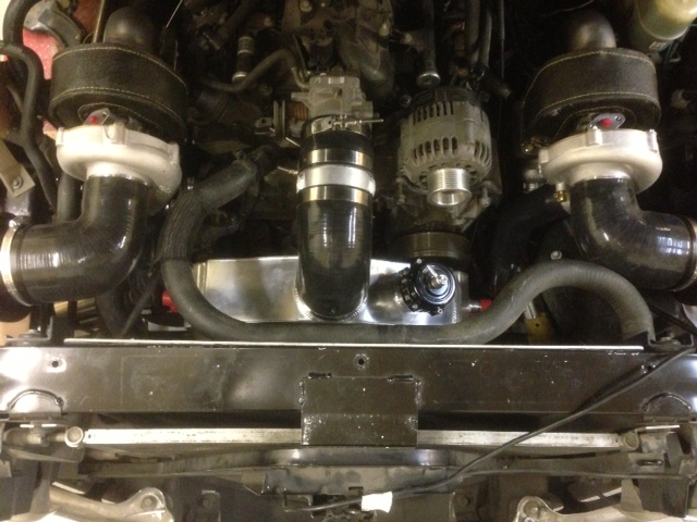

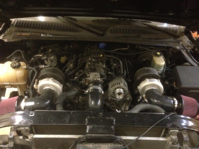

Old Feb 26, 2013 | 07:22 PM
  #210
TrickTurbo's Avatar
Truck Sponsor
Joined: Sep 2006
Posts: 4,466
Likes: 62
From: Wichita Falls Tx.
