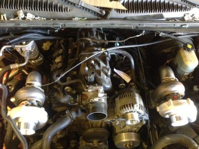

Yes down pipes are done. Went with some 3".
The intercooler is designed and started building it.
Massive 17x6x4.5 air/water build.
Everything stays in the engine bay.

From: Western PA
Looks nice, I wanna see pics of this intercooler when done.

So it's mapped out to only have 5) silicones for the cold side of things.
Dual inlet single outlet. 4) water lines.

Nothing esle to show right now. The intercooler is going to be next. Then figure out were to put the gates. things are starting to get a little tight in there.

Can't wait to see the Intercooler. What type/size heat exchanger are you going to run?

HX. I think its 28x18x2.25
